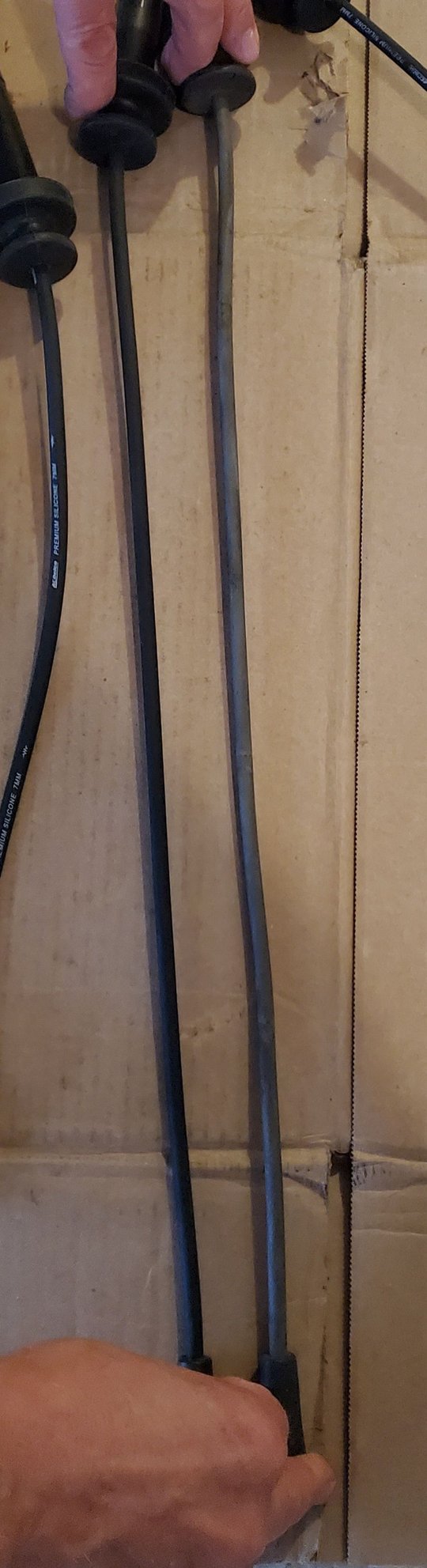

Btw the ignition wires new came weird length.
The two shorter length wires are the same Size as each other, so when comparing to the old wires there is quite a bit difference in length. Will this be an issue ? New ones on left
Old Feb 28, 2026 | 03:57 PM
  #37
Gunnar's Avatar
Joined: Jul 2024
Posts: 60
Nevermind. ..
The 2nd shortest one OLD was 18"
The 2nd shortest one NEW is 14"
Doesn't even reach. Anyone know a good brand wires to get? Trying AC delco did not work out , at least from rock auto.

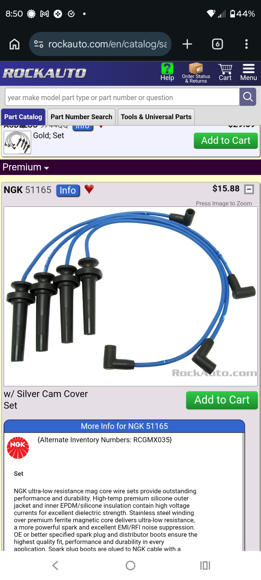

This is what happens when GM sells fulfillment of their AC Delco gold and professional lines to the highest bidder. I'm sure they were fine and the correct lengths way back when, but whoever has the contract now to fill those boxes is filling them with the ****.
If you look at the picture for the $30 standard replacement AC Delco wires, they are not four different lengths as they should be. The NGK set specified for the silver cover is
Which shows the four wires with four different lengths.
I'm not saying that the picture will always match exactly what you get, but apparently you have determined that we all must scrutinize AC Delco parts heavily before purchasing if they are not ACDelco OEM.
I would maybe try this NGK set.
Advance 24.50 store pickup or free delivery $35 Plus
Ngk.com 22.15 + shipping + 3 wk delay
Amazon 30.00 with Amazon prime
Partsgeek 29.95 including 10 shipping
To answer your question as to whether the brand matters, it seems that it does because not all of the manufacturers are offering the same set of wires. Sad but true. Welcome to the world of aftermarket Saturn support.
