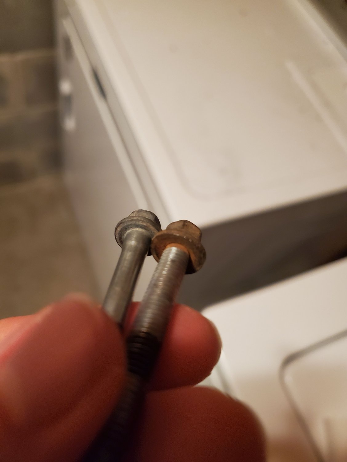

Does the cleanliness of the mounting bolts for the coil packs matter much? Youtube video said helps grounding. Was thinking I'll bead blast these bolts because even after cleaning still pretty bad at head. Or does it not matter much? Weirdly one coil pack had bolts that had threads all the way up and a washer, while the other had two bolts with smooth surface for threads only half way through and a wider flat part of head without washer

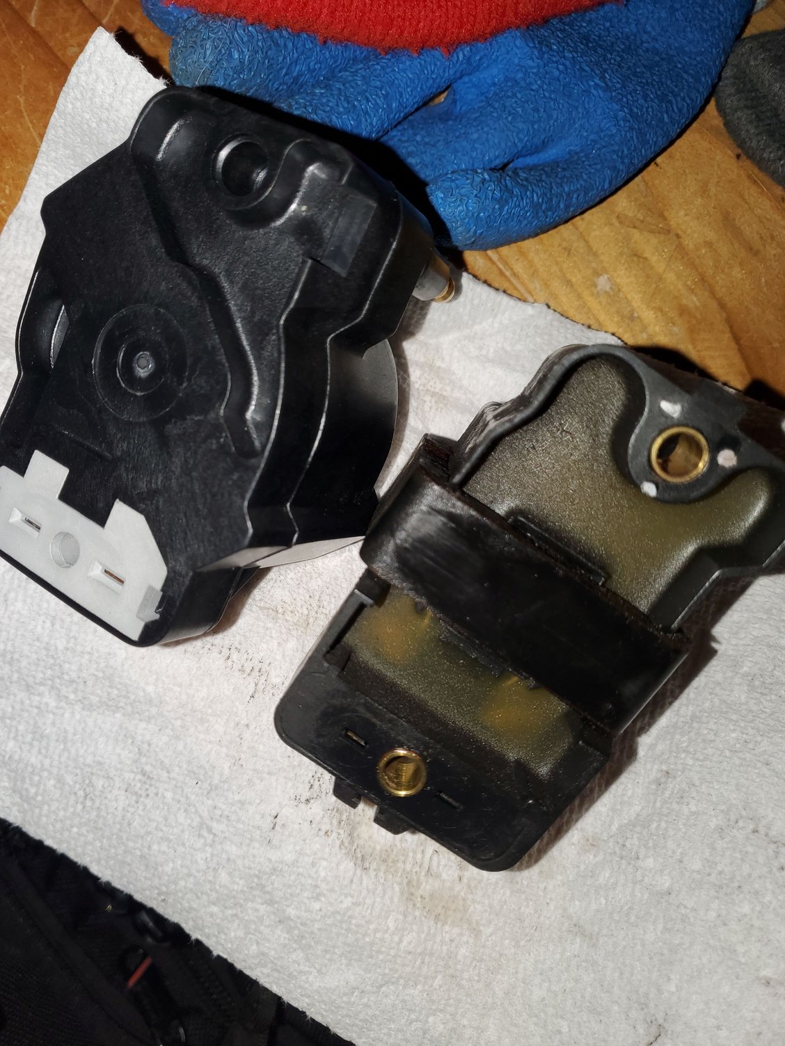

I'm also curious if I have good new coil packs. The old ones had metal contact in the bolt holes that go to the behind of the pack, while the new ones don't.
I'm kinda confused of the point of the two flat metal surfaces on the coil pack mount, on my new coil packs there is no metal surface anywhere on the back ? New one pictured on left. Old on right.

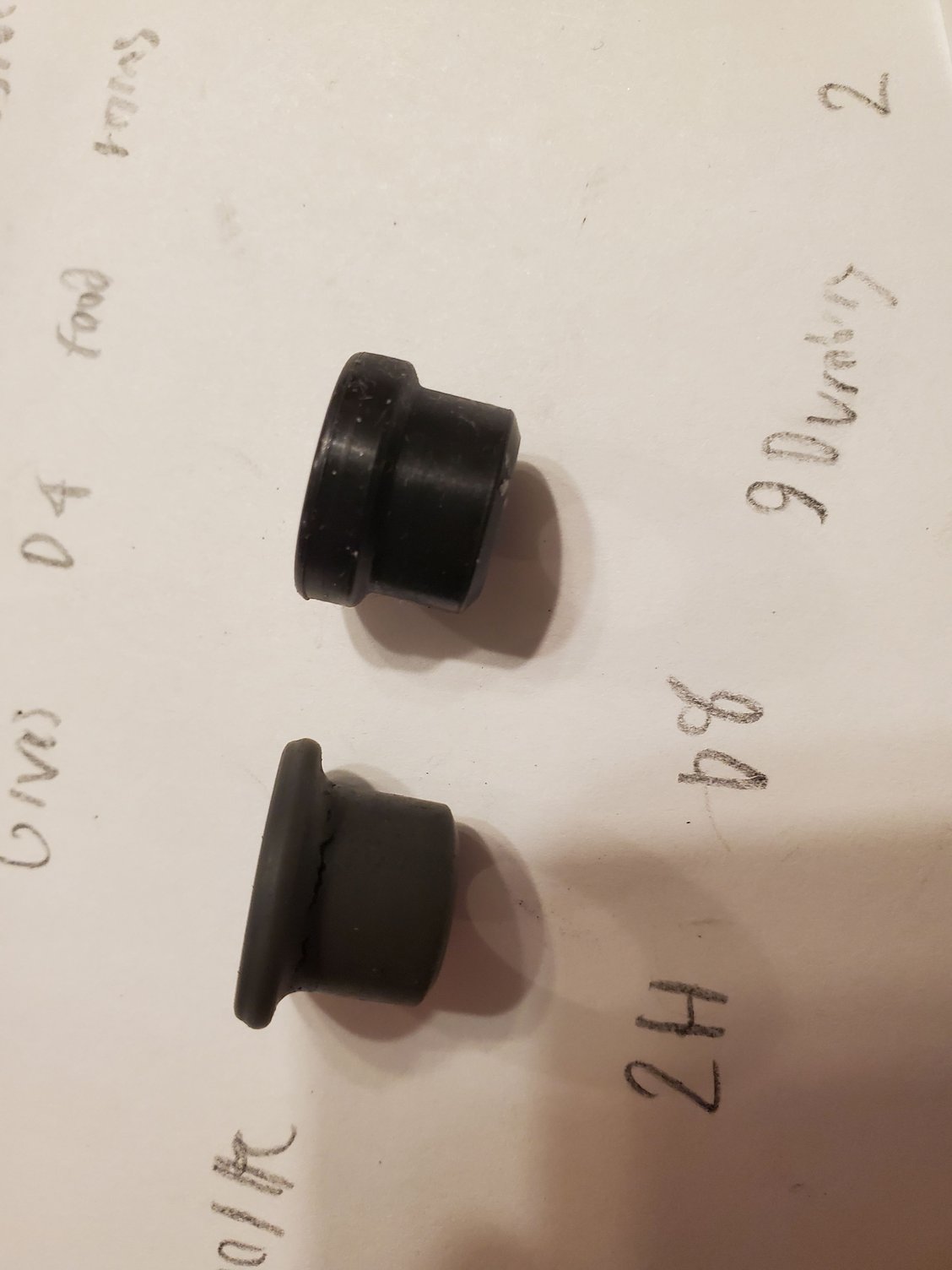

For some reason there is an extra grommet. And the new grommet (on top) is lot thicker on its top, is this an issue ? Do I have wrong grommets
Hand tightened atm but the gasket is loose still, I wonder if it's too thick , probably going to just tighten for now to the torque spec... any opinions?
