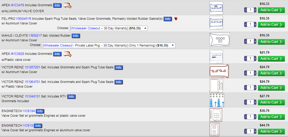

One issue just wondering about, the gasket from FEL-PRO seems like has interconnections at awkward spots for the spark plug tube seals. I don't see how they would fit? Should I get APEX or MAHLE/CLEVITE instead? There are only grooves on the outer edge of the engine, and on the 4 larger O's above the spark plug. No grooves between the plugs.
Apex has commectoons on center similar to what my car looks like, but there are no grooves between the O's in the metal.
MAHLE has just rubber O with no connections.
Very confused which would fit best

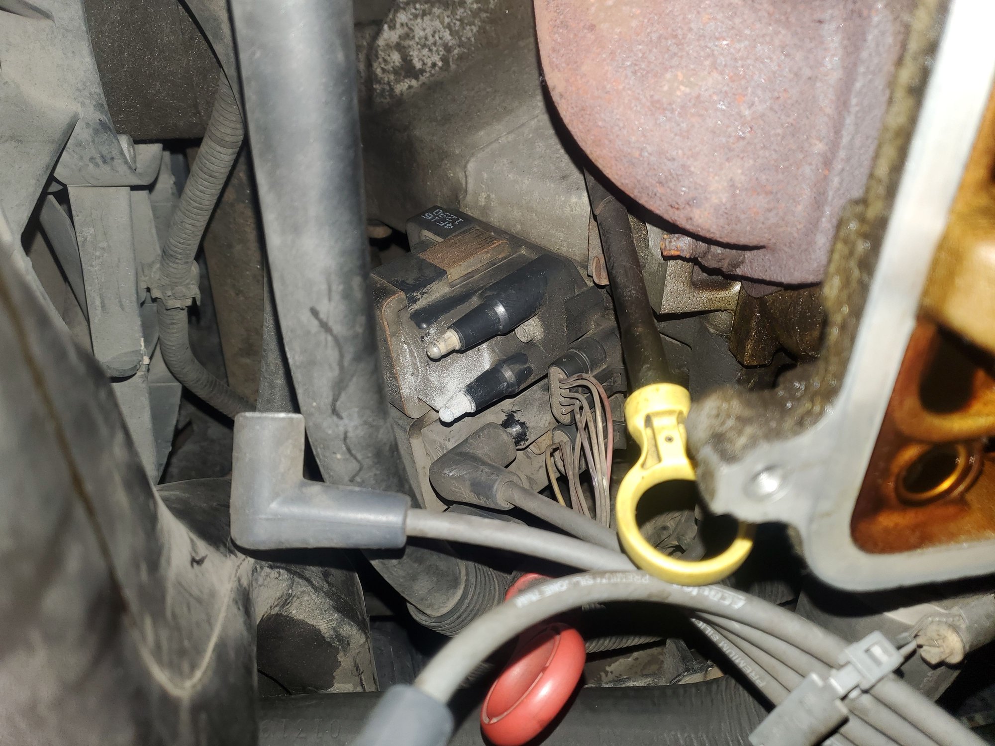

at least one coil pack has lot corrosion so think will replace both? Anything to worry about when replacing these or tips ?

When you install the four O s into the groove in the cover, you must be sure the holes in the gasket in between the cylinders line up with the holes that receive the cam cover bolts.
I think you're looking at the wrong / incompatible cam cover gasket. The one that matches your engine is shown below
The other pieces that come with the kit are insulators, one for each bolt that holds down the cam cover.
Also, the mating service must be completely free of residual gasket material. The spark plug holes have significant residue where the gasket is trying to seal. I think there is a bunch of stuff still on the back mating edge.
I'm not picking at you, I want this to succeed the first time.
