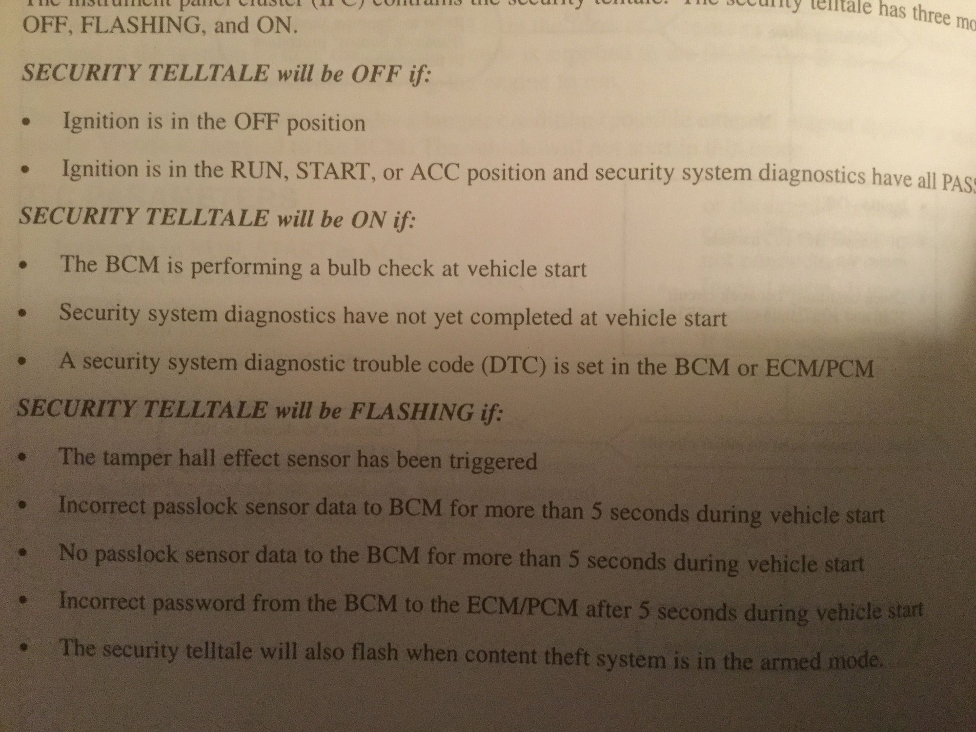

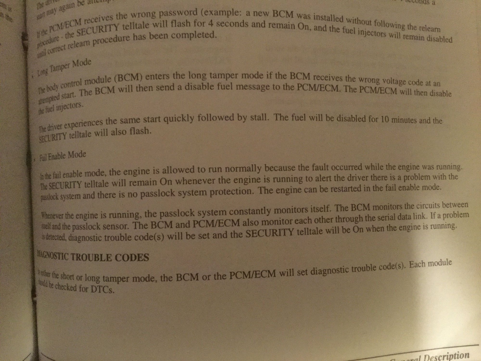

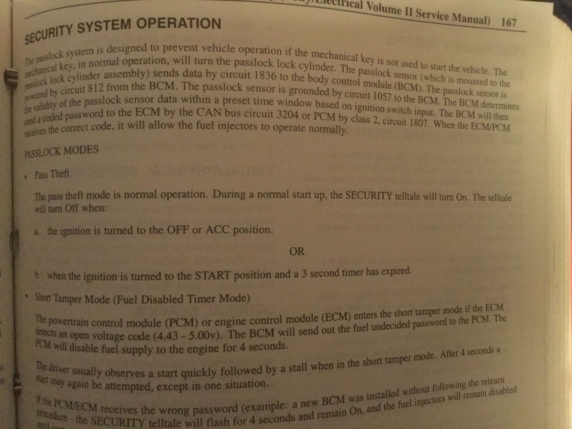

We tried that 3 times 11/2 hours and still nothing, the first two times light flashed, third time light was solid, did that 3 rotation times, 1 and half hours.
Old Dec 7, 2019 | 10:41 PM
Posts: 3,308
After the ten minutes did the light change? Either from on or flashing to off? That is when you move on to the next step.
Old Dec 7, 2019 | 10:46 PM
Posts: 3,308
Old Dec 7, 2019 | 10:49 PM
Posts: 3,308
Default It is the real service manual
