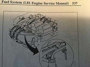

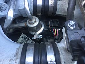

Okay: I was looking for the part that fits the 03 LW300 as shown for sale in retail stores . The regulator you've id'd on the engine is different in appearance. The longer metal hose extensions are what threw me off.
The regulator they show on Rock Auto is correct. It goes in from the bottom but it looks like there is room. There is a v clamp with one screw and the vacuum line points forward. The fsm has drawings, pictures are better.
Thanks: I'm pretty sure that I was misreading what the part looks like. I thought it was the entire piece, including the fuel lines. If I'm reading you correctly, removing the screw and v-clip will then make it possible to insert the regulator from underneath, as long as I have small hands?

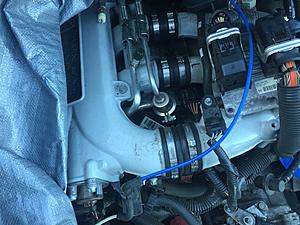

Turns out the original regulator is fine. I was looking for a sign of gas leaking from the vent but it was dry. Back to step 1.
