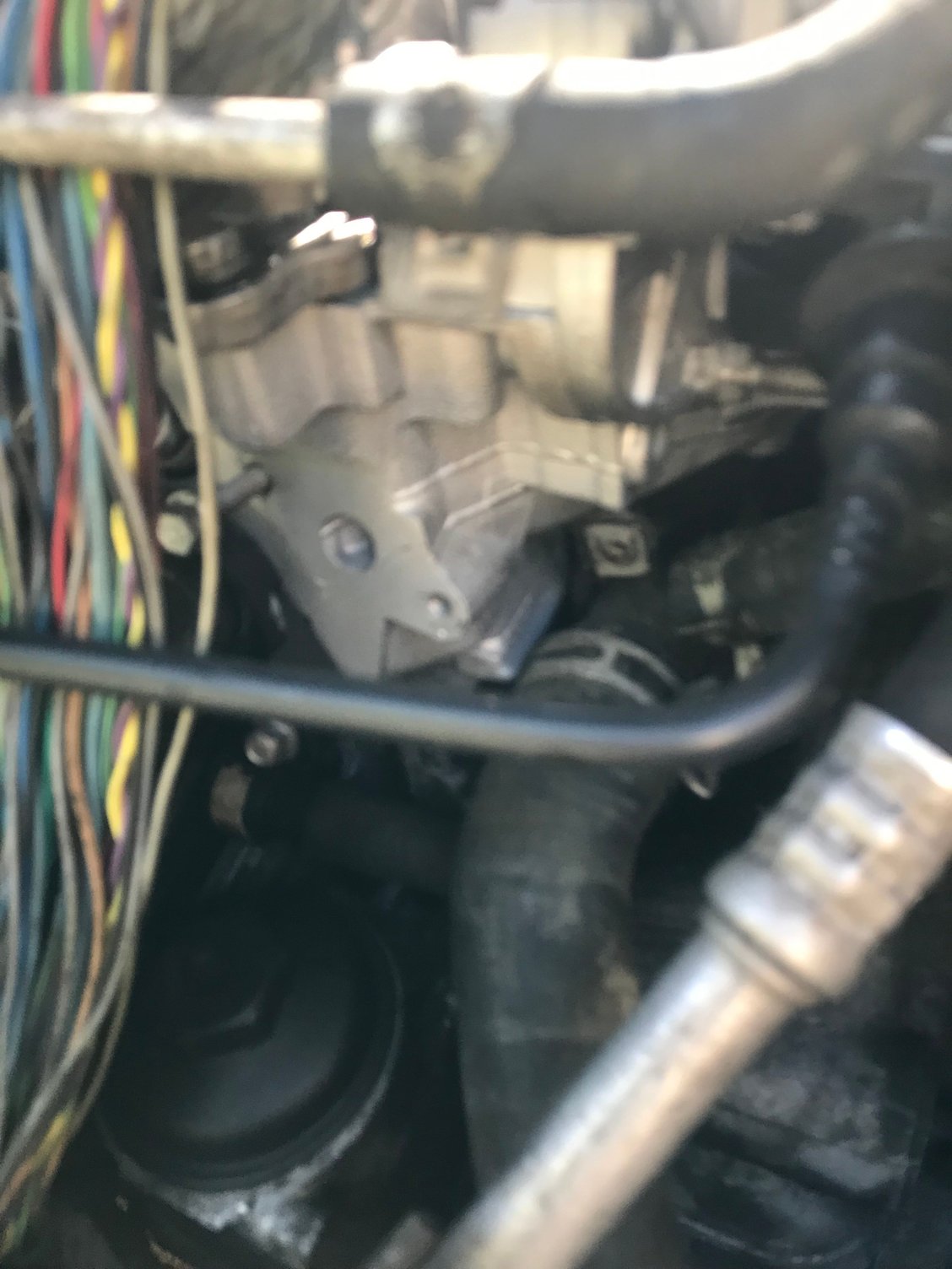

this may just be the whole answer but there is a hole with what looks like 2 bolt holes around it that has nothing on it position on the driver side of the intake it looks like something is there but i cant remember anything being there could that be my issue?

Picture of hole which you mentioned above?
@DropDead you out there?
