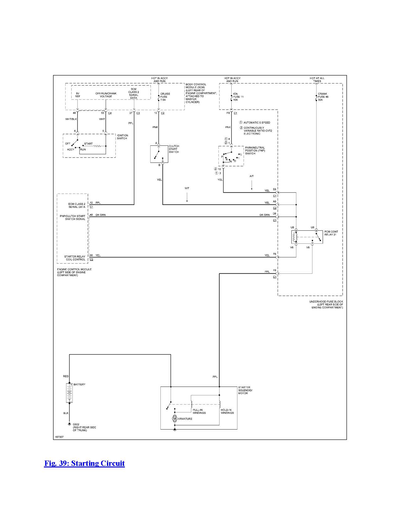

Default starting circuit
Try this for the circuit
