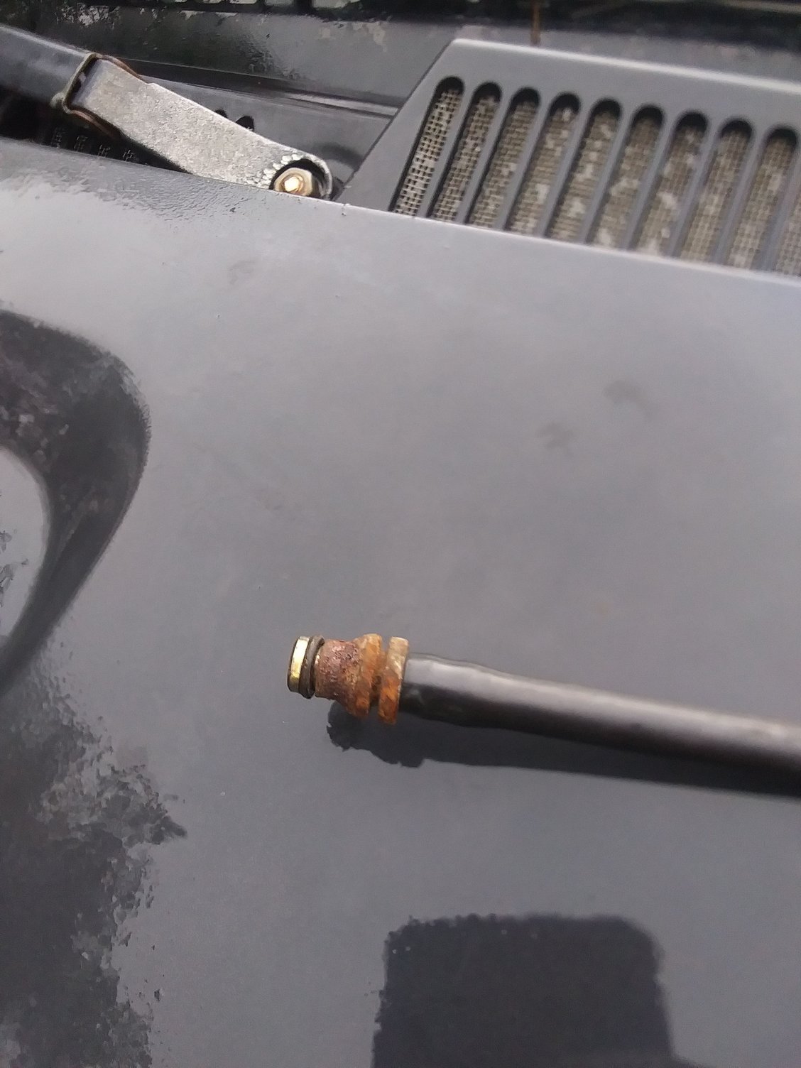

My clutch line was seized into the slave cylinder and I bit through the plastic line trying to pull it out with vice grips. These lines are no longer available anywhere that I can find.
The original GM part number is: 12584427
but this was discontinued at some point and replaced by 12587539.
That part also replaced these other ones: 12578562 and 22634600 so they might work too.
It looks like any year line will work, does anyone have one laying around I could buy?
Any other clever solutions?
Thanks,
JB

I do in fact have one. It needs orings though. I converted to the cobalt style for this reason

OK, thanks. I only called 3 or 4 of the places as you have to go through menus, get put on hold, etc, but those didn't have stock. I would probably junk the car as opposed to spend $70 that is listed for a lot of the dealers. I was hoping to get 400K miles on it, at 340K now. It seems that my slave cylinder extended and would not retract which is what got me into this mess. I did check ebay and found nothing there. I do have my hairpin clips and o-rings so I should be set if I can get the line. I will let you know if I can't get one from DD.

Old Aug 18, 2021 | 07:03 AM
DropDead's Avatar
Joined: Apr 2019
Posts: 854
Old Aug 18, 2021 | 08:26 AM
Don't reuse O rings. Buy some new ones. Just take the line or the old ones with you and make sure they fit correctly.
Old Aug 19, 2021 | 12:10 AM
What material are they made from? It looks like the same color material that they use to make fuel injector seals
