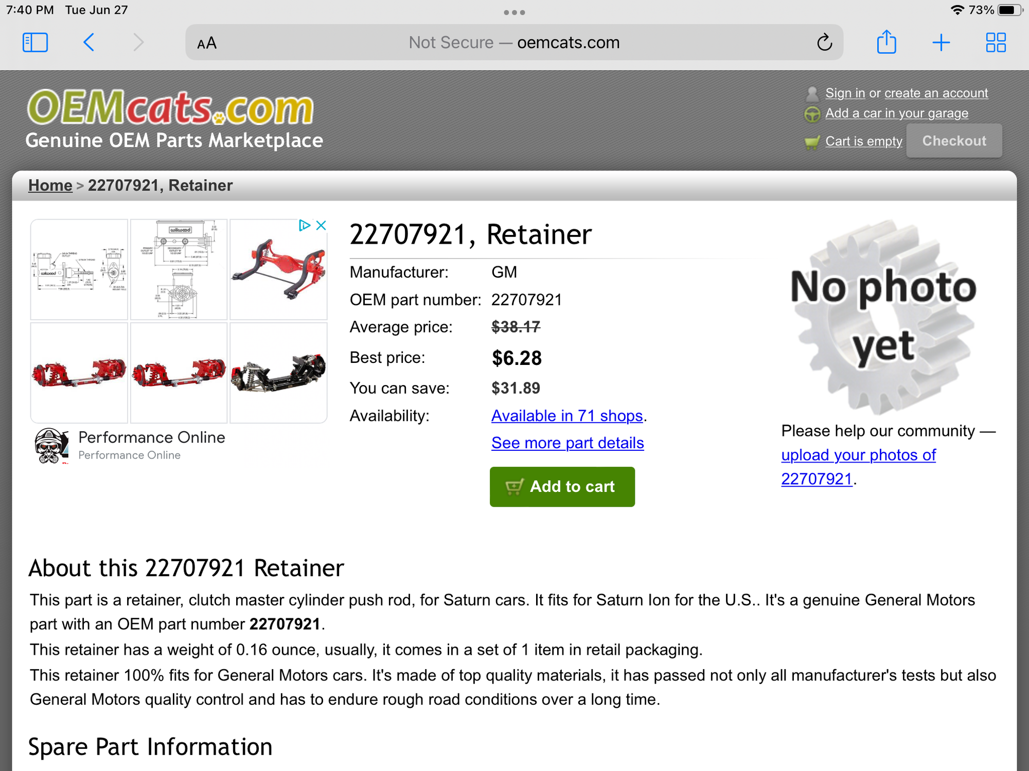

derf, unfortunately, I don't think it's the same. The bushing/retainer I'm looking for holds the Clutch Master Cylinder rod in place against the pedal. I think the post you referenced is the base plate that clips to the back of the pedal.
To me it looks like a ball and socket joint. Here's a better diagram of what I can tell:
O2 LW300, I took a look at OEMcats. I can find the part there, but when I add to cart, it forwards me to one of 71 shops. Sadly, each shop site I go to shows it as unavailable for purchase.
