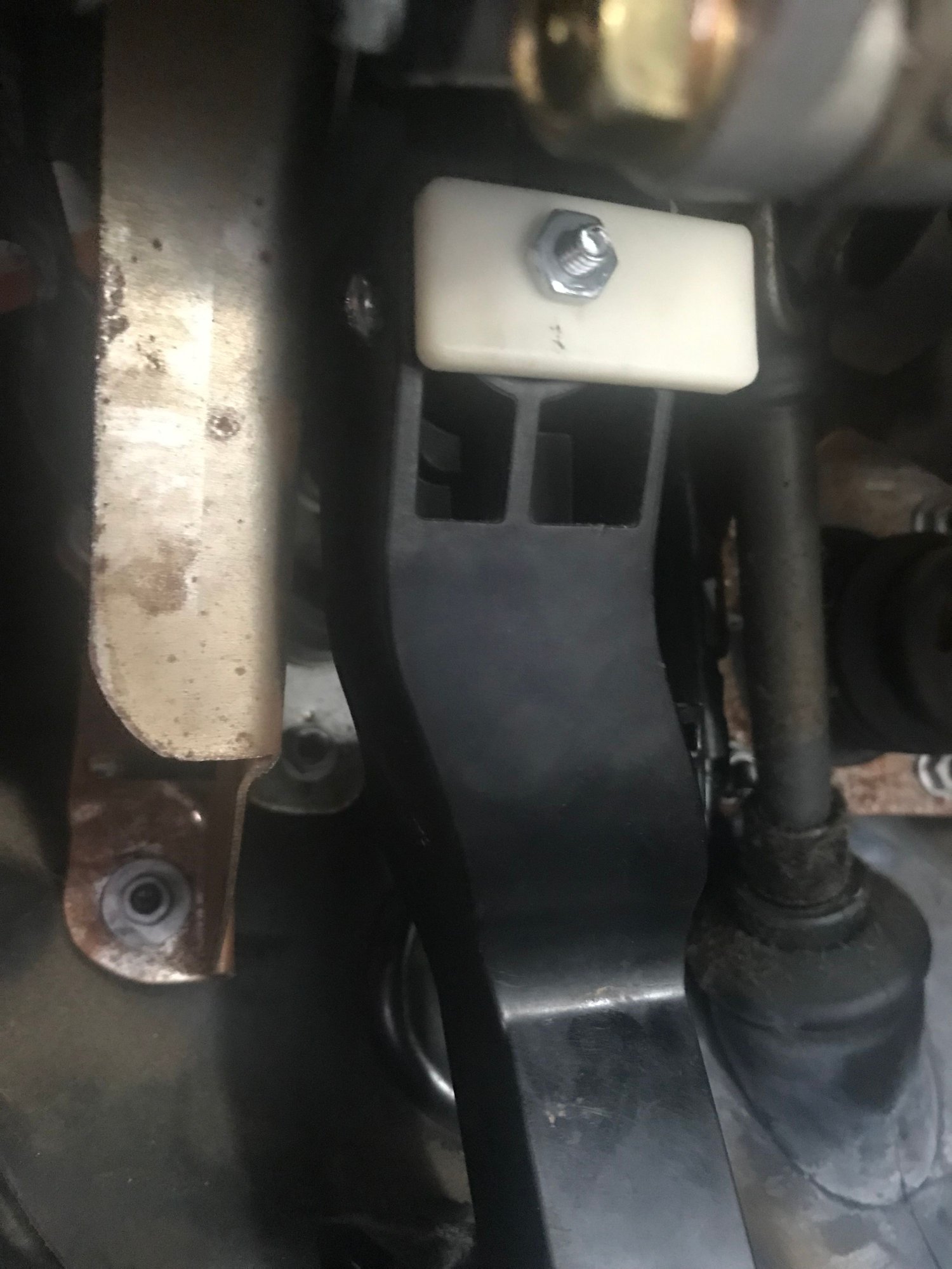

Anyone who’s driven an aging Saturn Ion knows the woe of the broken clutch pedal... it comes up off the master cylinder rod and eventually the rod will punch through the backside of the pedal and you can’t properly disengage your clutch... here’s how I fixed my clutch pedal...
I bought a package of #10 machine screws (not sure what thread pitch)and nuts for like 97 cents, and drilled a 3/16” hole through the white clip that is on the clutch pedal, which unclips from the one side... removing the clip you can see the hole that the clutch rod can poke through (didn’t get a pic of that). I put two nuts on the machine screw up near the head and stuck it through the hole, secured it with a nut on the other side, like shown
This allows the screw to poke through the hole in the back of the pedal and contact the clutch rod directly, the screw (being metal) shouldn’t wear down against the rod like the plastic pedal did...
when installing the clip back on the pedal, you’ll notice that the clip, being attached on only one side, won’t hold still as you push the clutch pedal, you’ll need to run a sheet metal screw into the side of the pedal to secure the other side of the clip, and allow the clip to hold the pressure from the clutch rod...
Next, I made a pad about 1/4” thick from old useless wire that stops the pedal from overextending upward, not that it would come off the rod anyway, since the rod is no longer bottoming in the pedal, it’s contacting the machine screw...

This pic is showing the installed clip on the pedal, and the sheet metal screw in the side of the pedal... in theory if you attached the nuts on the pedal side of the clip to the clip itself you could adjust the machine screw and thus, the clutch engagement point. I hadn’t thought to do that at the time of install, and I’m too lazy to tear it all apart again to modify my fix, but I may do that later on...

thank you for this idea with the screw! I just tried it with minor fixes and works perfectly!

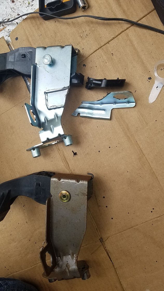

I did everything but my wfes to-do list trying to fix my 250k pedal/ push rod set up.... many videos I made. Finally swapping the clutch pedal for new, w/ modifications + had to add a 'in the hole' rubber bushing due to push rod ball worn too much - which was also so worn I couldn't 'clip ' the ball in w/ the white retainer - so I had to also install a 'pedal retracting too far' mini vise grip down there.
QUESTION:
If you swapped the clutch master cylinder, where you able to get the bleeder hose retracted after clip removal by the housing up front?....
I've tried everything to get that to pull back and don't want to break anything.
clip removed but nylon hose won't slide back for bleeding

new
new
had to make some chop on new
