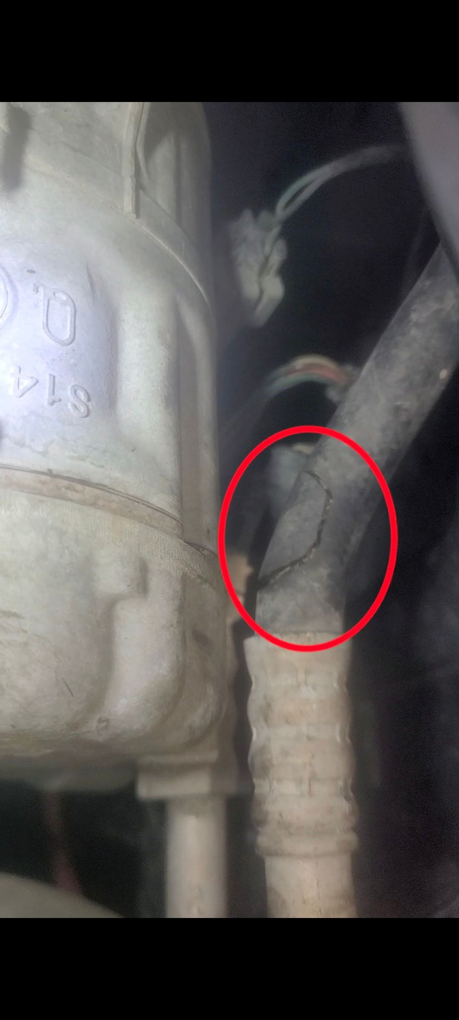

Old Aug 28, 2025 | 02:49 PM
That1dude's Avatar
Joined: Mar 2024
Posts: 155
I finally found the leak that has been causing a hissing sound. I attempted to pull a vacuum, and it wouldn't hold, straight back to 0 after turning the pump off. I attempted to add a can of refrigerant with dye to see if I could find a leak, and I at least got the readings on the gauges to go up a little. I then started to hear a hissing sound I heard last year when trying to recharge on my own. I'm sure that's when the hissing initially started. There had to have been a leak before that tho and that's why i was trying to recharge. At that time, the ac worked for months and then would only work for an hour or so before blowing warm air. Let the car sit from an hour to as long as overnight, and the ac would be back blowing cold for an hour or so again before going back to warm, but that's another story.
So I got under my car and rubbed around on the compressor and hoses and found there was a tear on one of the hoses that came out of the condenser to the compressor. Happy I found it! I initially thought it was near the firewall and could have possibly been the evaporator core.
Anyway, what could be the reason I only feel air when placing my hand against the torn part of the hose? Shouldn't it be leaking with refrigerant? When I point the black light at it, I can see it glowing green but only on the inside of the hose, on the mesh/net looking part. None leaking on the outside. So, where's the refrigerant going? Or am I missing something or not understanding something about how this works? Maybe me manually pouring the dye in through the low side hose on the manifold gauge has something to do with it? What's the reason for only air if refrigerant is supposed to leak in the form of liquid/oil?
Thanks
Edit: The hissing sound only last but so long. Maybe like a minute before it stops from refrigerant running out, so I had to move fast. Glad I found it on the second try since I only had purchased two cans
