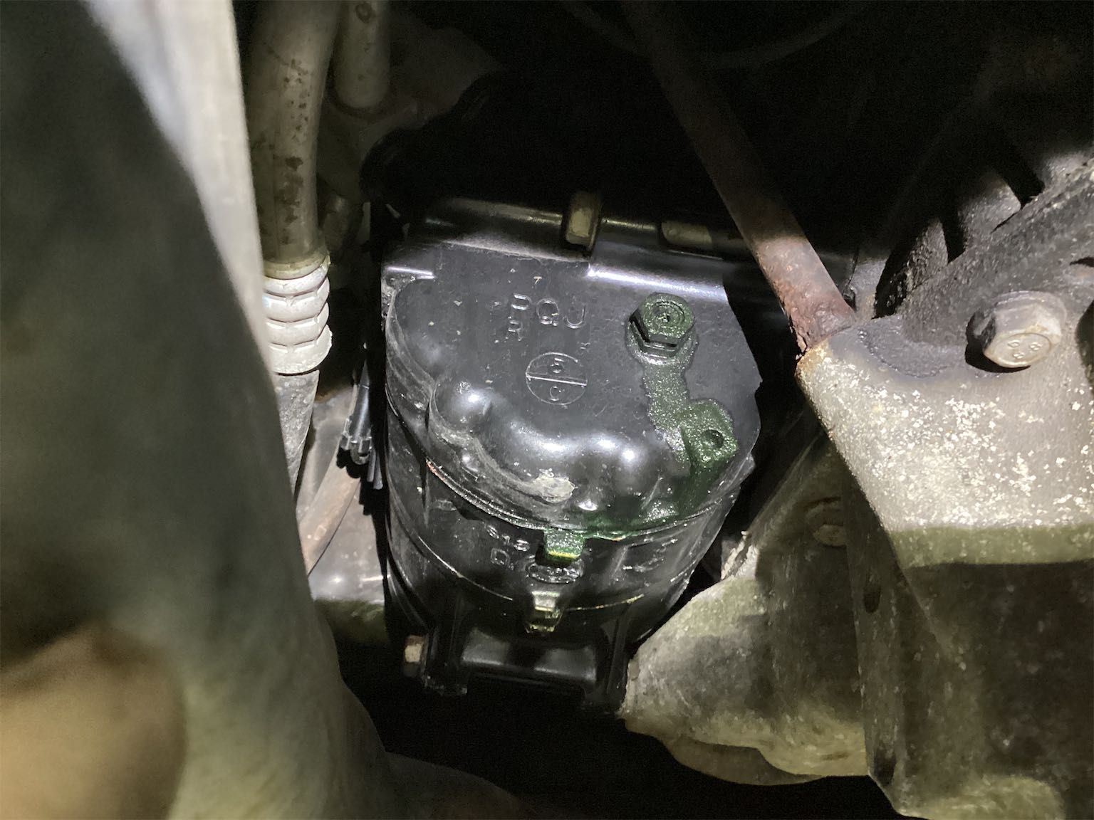

It was from a report over two years ago. I tried out a new shop for the first time. Worst one iv ever been to. There greed and bad practices make my old dealership blush. At the time, my saturn was about 17 years old. They tried to sell my on almost $6,000 of maintenance items. And that estimate wasnt including everything the recommended; and did not include anything about the ac system. - One of the issues was my car not starting or not starting right. Turned out it was the cam shaft sensor. They wanted 250 for the part plus installation. Later after declining everything, i got my own part for ~$15. But i did have them install it. I wasnt sure how to at the time. They wont install customer parts but did for that one so i could get my car off their lot. I later found out it was just a single screw. Took all of 1 minute. $50 for that. AND while doing that, they cut my vapor canister purge valve hose. That thing is rock solid plastic. You cant accidentally nick it. It was also a huge gash. And its location was just at the one spot where you cant see it visually when looking down. I found it when i traced it with my hands and felt something off. It causes my car to sputter and almost stall out from the moment you turned it on because of the airflow escaping. So i know for sure it wasnt there before my car went in. I absolutely believe they sabotaged it.
Anyway... that and more... so i tend not to take anything they say seriously at all.
But one thing they mentioned was that they ac compressor was leaking and the ac condenser was leaking. Now again, i dont take what they say seriously, but they did include two pics with the report. ... unless they were pics form a different car they tried to slip by me. It wouldnt surprise me the way they are...
But if it is my car, then maybe it explains some of this... (these were from 2 years ago.)
(sry i just recalled those pics...)
(They wanted about $2000 to replace those two. On top of everything else.)

It looks like there is dye in the system shown in the photos of the leaking compressor and condenser. If you get a cheap UV flashlight from Harbor Freight or Amazon it should be obvious if the photos are of your car.
