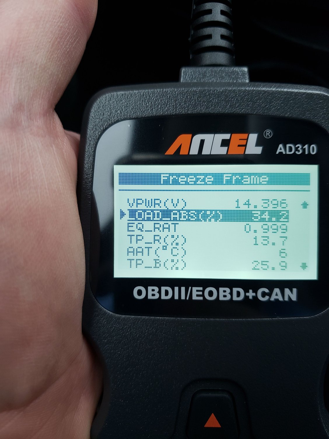

More help needed and would be appreciated. Check engine light came back after a few days and 2 tanks of fuel. Does anything look out of the ordinary?

I do not doubt that it will continue to throw the same code after you let it warm up. The percent load and percent throttle are likely indicative of the vehicle only being running for 31 seconds. Same with the low e c t s temp and other values that have not stabilized.
Since the reader reads real-time data, get the car up to operating temperature, turn it off, put the key to on, clear the code. Leave your scan tool connected to the port. Restart the vehicle, reconnect through the diag port ASAP. Watch for any readings that are way out of line.

I I believe you will want to watch the fuel tank pressure, the state of the EVAP vent and evap purge solenoids. If the EVAP vent is stuck even the slightest bit open, the system will detect the leak because sufficient vacuum can likely not be maintained during the EVAP test that keeps running.
I believe the Purge evap solenoid is commanded to open when the fuel pressure in the tank rises to a predetermined level. So when it is not pulling vacuum for the test you should see the pressure in the fuel tank rising. For the same reason stated for the EVAP vent, if there isas a leak in the system, the pressure may not build sufficiently or quickly enough. Though I believe that would have its own code in theory.
Hopefully your tool can capture freeze frame data when the code sets after you have cleared it as described above. This should give us significantly more information as to what's going on.
