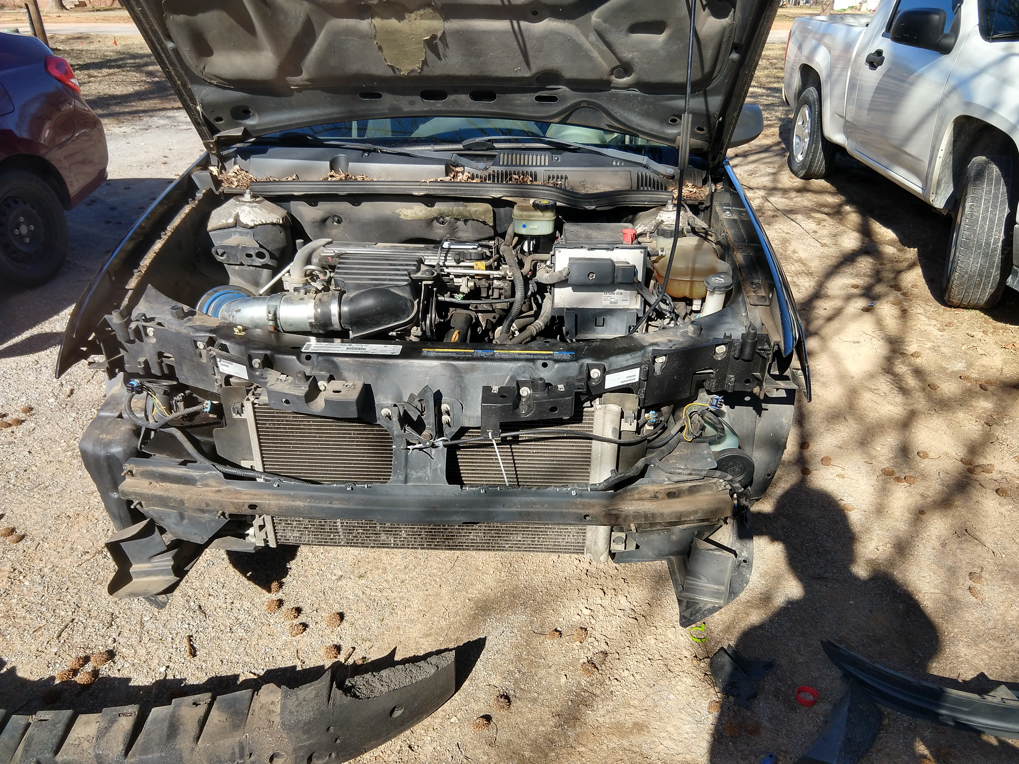

Today, I had some extra time so I went to the salvage yard. Picked up a bumper that was straight.
Pulled the front of the car apart, and it's not as bad as it could have been.
Had to get the saw out, the holes didn't line up with the nuts anymore.
All apart, nothing terribly crooked.
New bumper.
Everything more or less straight again.
I also grabbed an air filter box and installed it. This is when I found out that nobody locally has the air filter for this car. They say "We can order that for you and have it here in two days!!" And they wonder why Amazon is taking over. *I* can order it and have it here in two days, and pay half as much for it.
