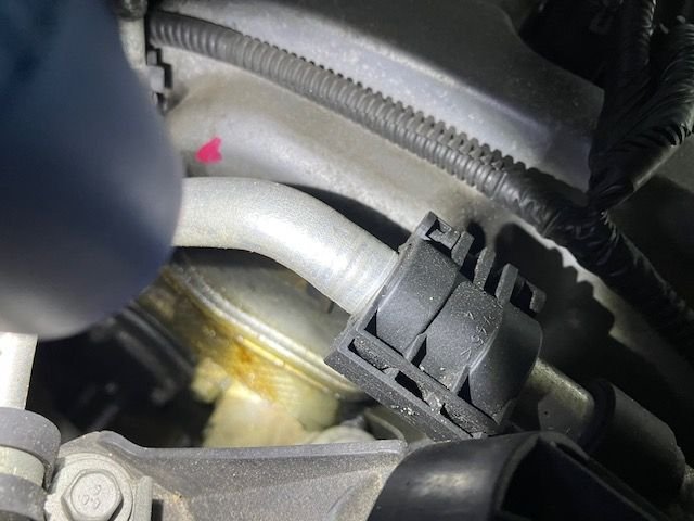

Mr. L300....Not 100% sure just yet but you might have saved me some busted knuckels and a very sore back from wrenching under my boy's car all day....I'm 73 and although I'll do it for the kids, I hate working under a car. I posted a picture of the leak from the valve cover. Although, the leak does not look nearly as bad as it does in person, it's leaking all the way down the engine. There is also a smaller leak on the other side of the cover. In any event even if there's leaks from other places the valve cover needs to b addressed. Thanks for your helpful reply! . .

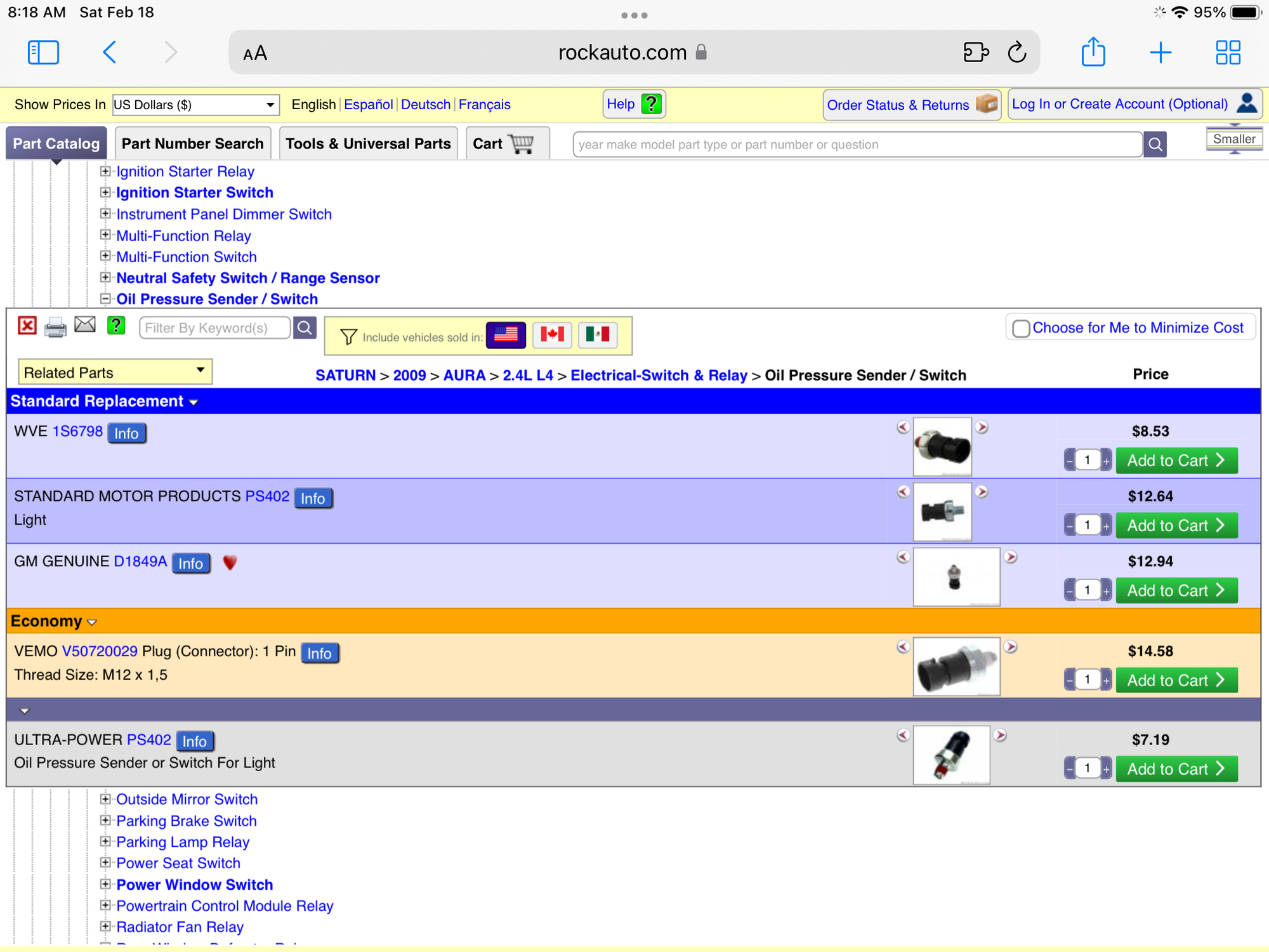

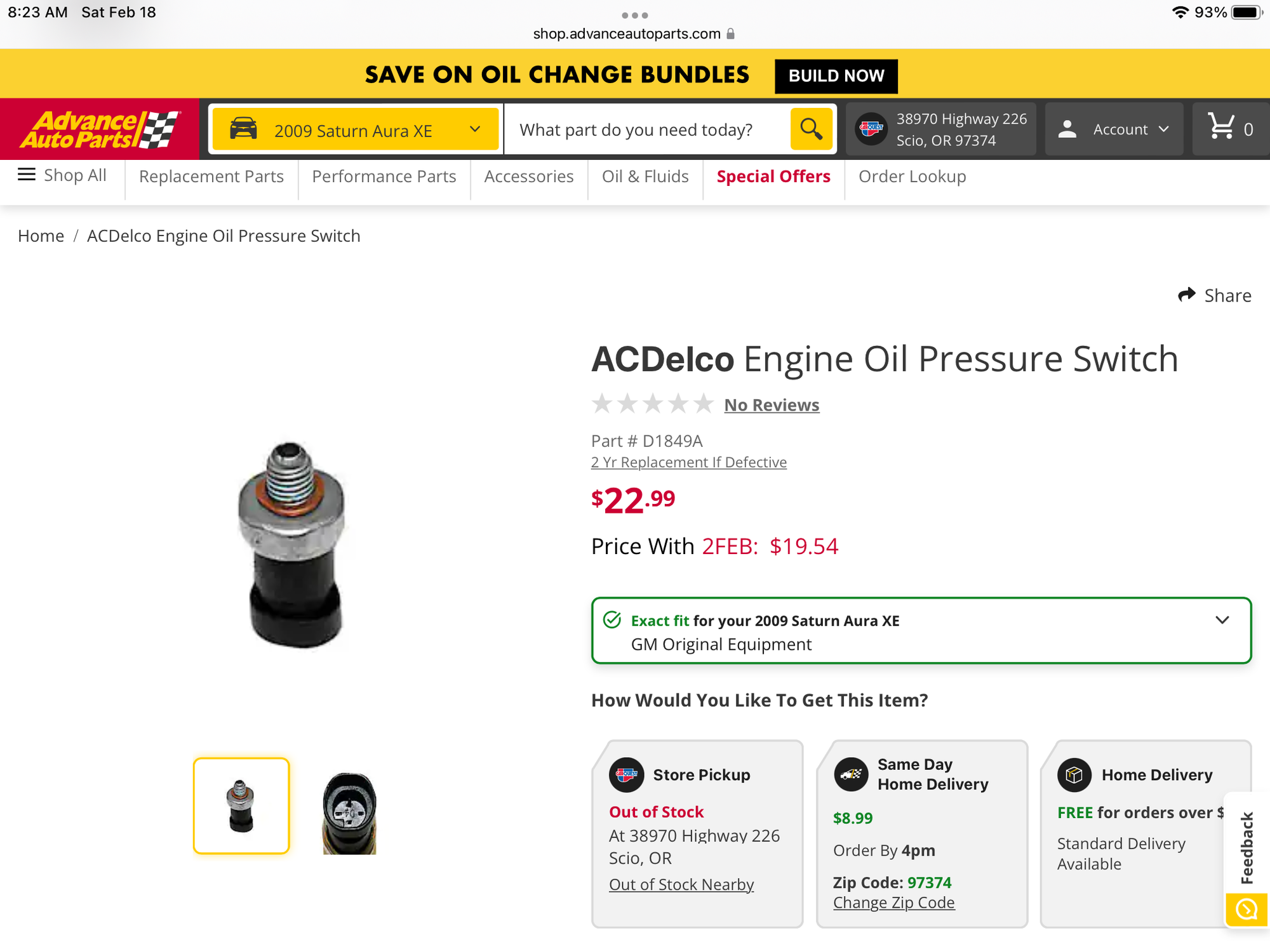

LW300; Just what I needed. I've purchased items thru Rock Auto before and like them but since my boy needs the auto soon I'll probably go to Advance. Although, my boy is playing video games and doesn't care about oil leaks, I do and I appreciate your help!
