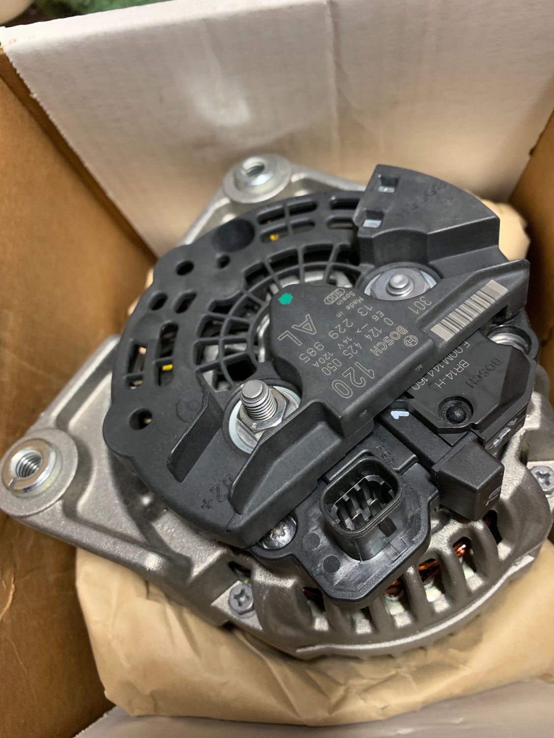

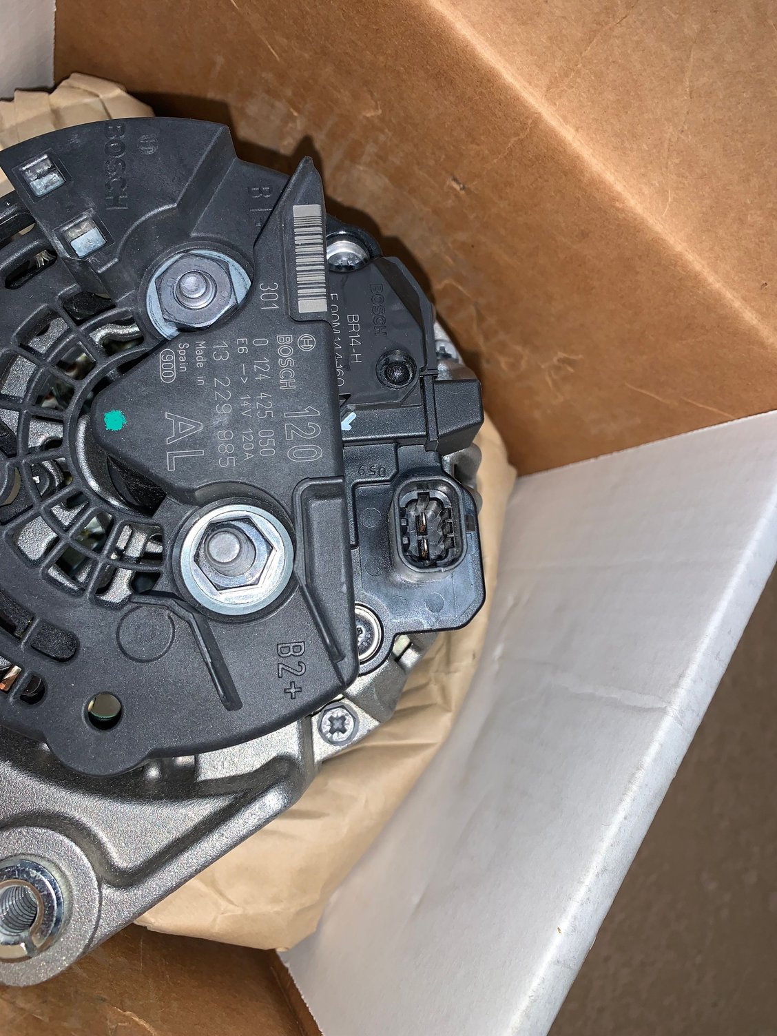

This is what a new GM OEM alternator looks like (it is labeled Bosch 120A made in Spain). I don't know how the 2008 installed alternator might differ (other than a clutch pulley was added to the auto transmission cars in a service note and on the "updated" alternators)
The "push" connector which I think had a security tab was very difficult to remove. We can see the female side of that which might help when thinking about removal on the car, where things are tough to see and reach.
Service note shows an additional two wires bolted on; I'm not sure I remember that extra (ground?) wire.
