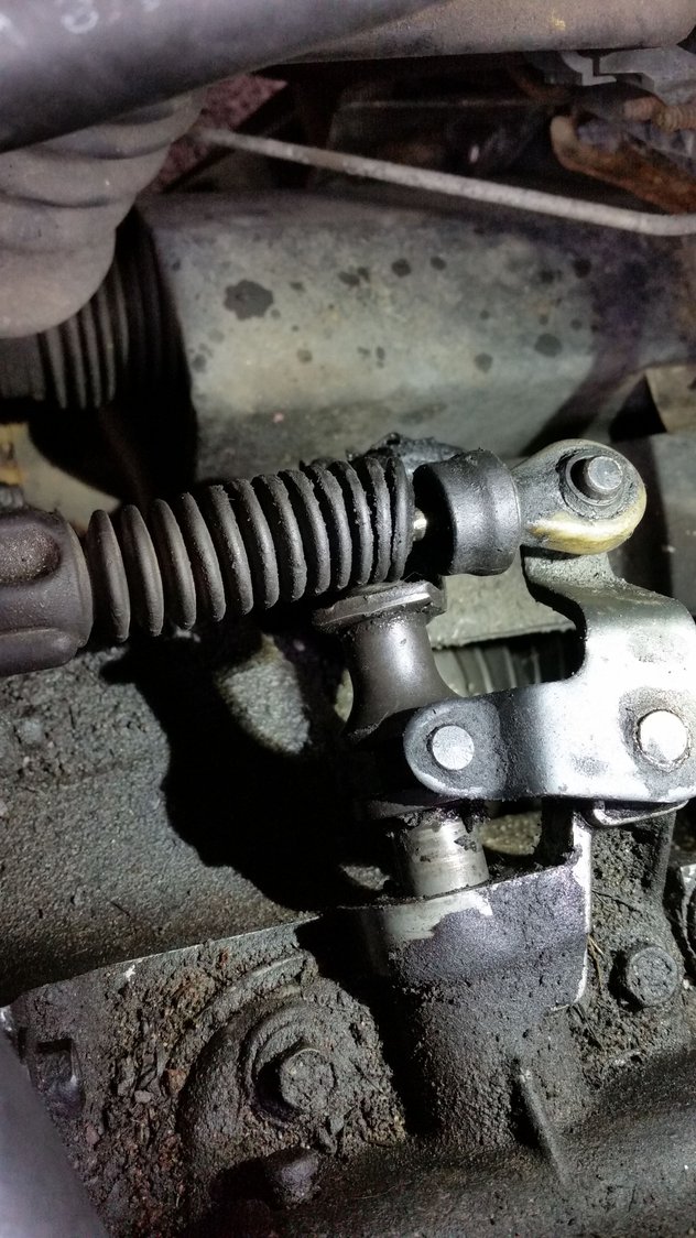

The following pics are my best attempt at showing the linkage positions at the transmission connection for every gear. Upon further review, the neutral lever (which in previous pics was not in the correct position) was loose and I was able to get it into the proper "slot" as previously discussed. It would seem that the pivot point for this lever is worn causing it to move slightly up/down which enabled me to get it into the proper position. Also, it does not appear as though the pivot point would be a easy replacement unless, perhaps, it could be drilled out and replaced with something similar. I tried to work it though the gears to see if anything would bind but no matter what I did it never seemed to get into reverse despite having full range of motion in the neutral gate on the shift tower. I did remove the other cable from the shift tower but it seemed to move freely.. I'm open to suggestions.
1st Gear
2nd Gear
3rd Gear
4th Gear
5th Gear
Reverse

Reverse should be farther in on that shaft than 5th. On my car fifth is over and next to third but reverse is not directly behind it is offset some more. Try pushing the shaft a little farther in than when it goes into 5th and see if you can find reverse.

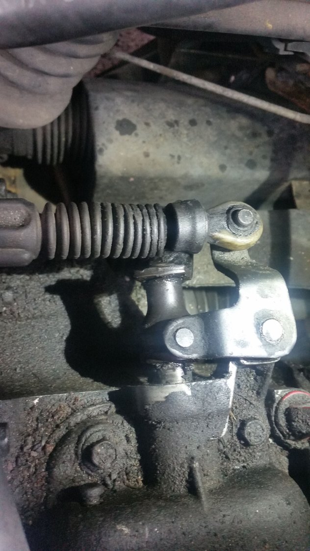

Andy.....my "reverse" is, in fact, straight down from 5th which is unlike yours. However, here's the good part....I finally got it into reverse. Both cables were disconnected from the transmission and thru numerous attempts of "working" the lower lever in conjunction with pushing/pulling the shaft that goes into the transmission, it finally...finally... did I mention finally?....clicked and went into reverse. The pic of shaft position is below. This leads to my next question: Does this now point to bad cables?

I bet your cables are still serviceable, in your first pictures the “lever” was in the wrong “slot”. I would look at the pin that is part of the lever and see if it is worn enough to let it slip to next slot. If so maybe a welding shop or a machine shop could replace the pin and solve the problems. Just thinking.
