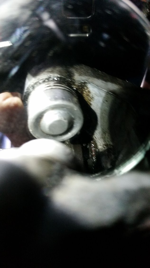

Well, the weather hasn't allowed me to do further investigation until today. Here is a pic of the bottom of the pin that holds the "L" shaped shift bracket on the transmission. My initial take on it was that it's some type of round nut that might just need to be adjusted to tighten, what appears to be, the threads underneath it. "Or" what looks like threads could be a spring. I need to get in there and see if its' adjustable.

I have been thinking about this and the guys over on sixth sphere seem to run a lot of S series cars. They also post about turbo charging their engines and having the transmissions fail. I bet someone would sell you a low mileage shift tower in good shape off of a blown up transmission. It seems that the differential pin retainer fails and the spider pin then slides out destroying the case. Bonestock on this site is over there a lot and knows a few of the members. I can start a contact chain if you would like, I have his number.

Well, in case someone else experiences the problem I've described and depicted, here's the latest. I jury-rigged the "L" shaped shift lever with some zip ties to hold it in place to see if that would verify my thoughts about it being the actual problem. It worked for about 2 days then it went back to having no 5th/reverse gears. The lever was back in its "bad/improper" position. After disconnecting the (2) shift cables from the tranny and manually push/pulling the shaft coming out of the tranny, I got it back into reverse. I was in the process of reconnecting the shift cables when I noticed that the cable that connects to the "questionable" lever would create either downward or upward pressure (torque) on the lever depending on how you connected it. The initial way I had it connected was exerting upward pressure on the lever causing it to be, well, sort of loose. When I took the cable off and turn it (by this I mean is that I just turned the round connection point on the end of the shift cable from one side to the other side) it created downward torque on the shift lever which firmed things up quite a bit. It wasn't floppying around like before. So, I took it for a run and shifted the beegeebers out of it with no problem. After the run, I grabbed the lever to see if it was loose and it was "not". It was 100 times tighter than before. So, I'm going to run around with it in the coming weeks to see if I run into the same problem. Andy, I did not take you up on your offer regarding a contact chain to Bonestock as I may have a bearing on a "transmission control lever housing kit" in the near vicinity so I wanted to check that out first. Again, I'm back on the road and hopefully for a longer period than before. I want to thank you and Derf for all the help you've provided. I learned a lot and it's "people helping people" that really works in this world. Oh yeah......"LONG LIVE SATURN".
