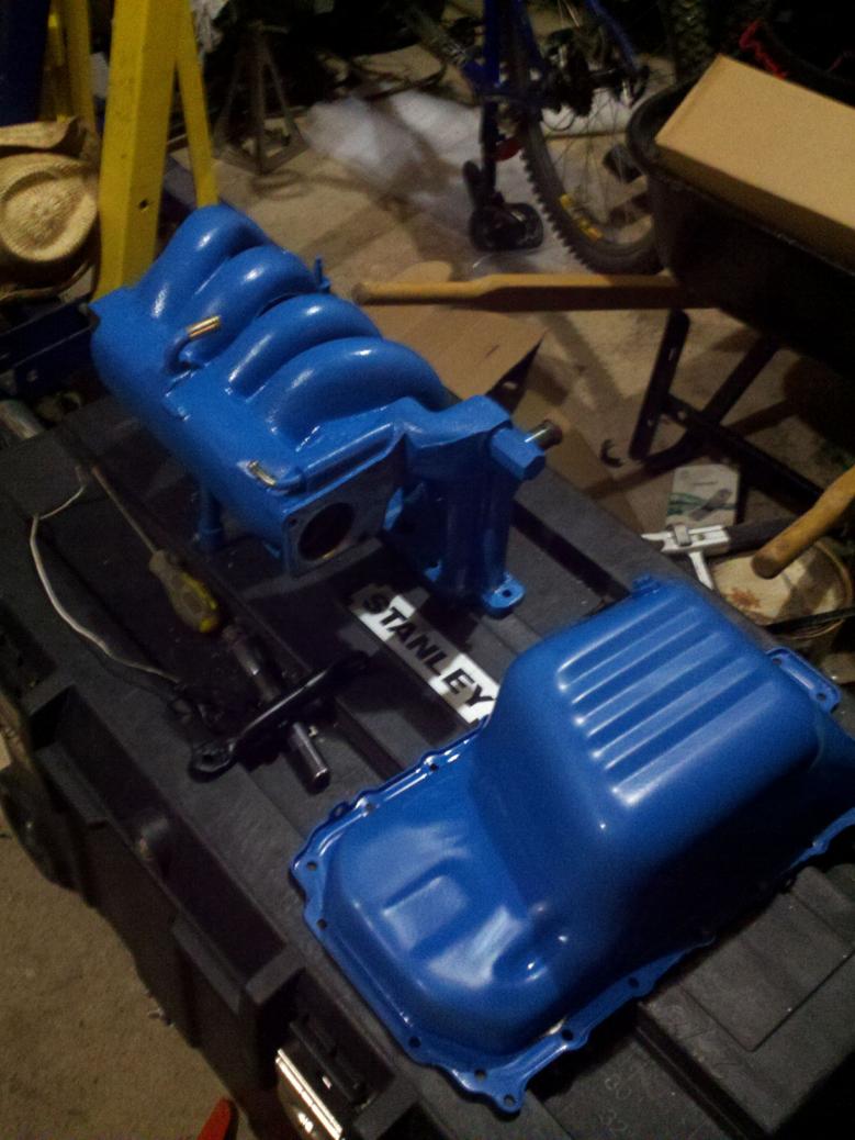

Things are winding down.
All engine parts are ordered, engine assembly is on sunday. after that all I need is the clutch and ill be good to go!!
Cleaned all the nasty out of my intake manifold, then shot it (and my new oil pan) up with some paint. I plan on putting the homecoming gauges in the car on thursday

#25
They are looking good. I guess when I get to the point where going back together is taking place I start getting excited. I am getting ready to weld up the transmission mount I fabricated and I am getting a drive shaft made. I have some repainting to do but the answer to the same question Ruby asked, what did you finally do about a cam shaft?
