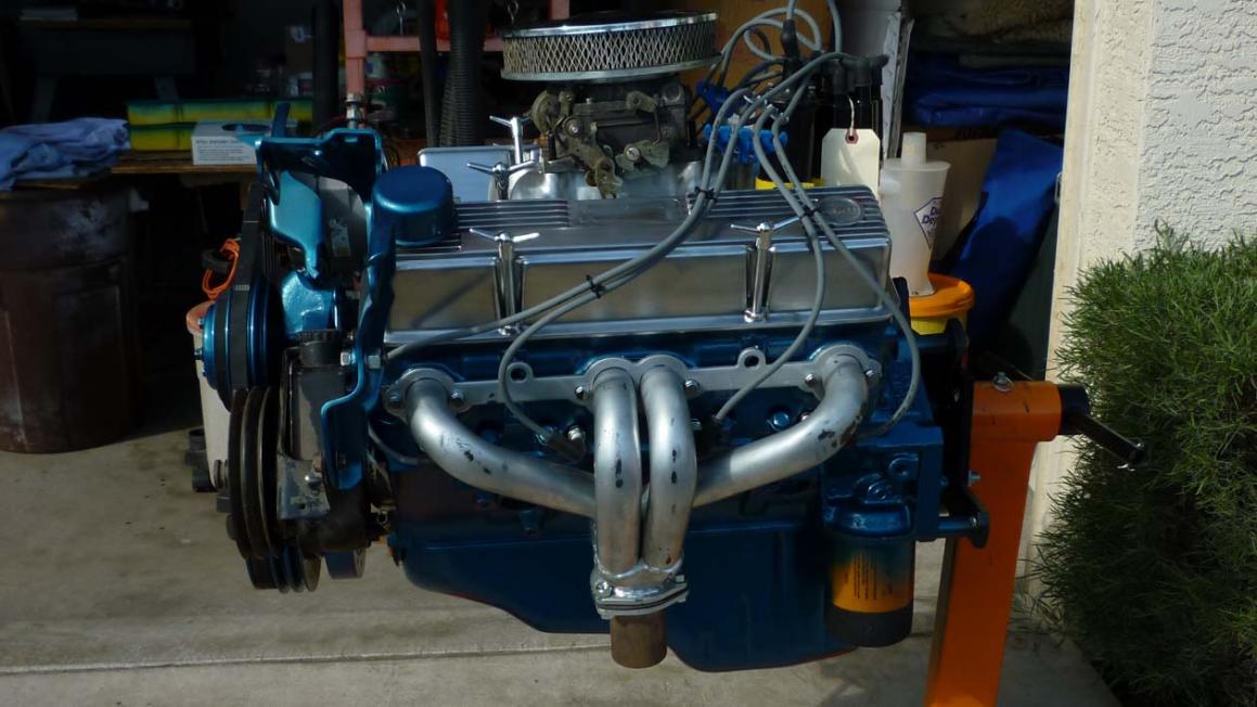

An update for the present.
My Mercruiser Motor is now in the present configuration. Assembled with a new Iskenderian dual pattern cam. Many aluminum, not all but many pieces polished, more to do.
The mounting brackets for drives and alternator have had the ugly trimmed out of them.
Paint color is an AMC engine color for late 70's, a catalysized Acrylic Enamal. I am still working on what engine mounts to use, am beginning to favor a hot rod universal mount and am beginning to take measurements to install in a 1976 AMC Hornet Sportabout, a Station Wagon. I have decided to use a 700R4 automatic with Lokar shift and a lock up Torque Converter. I will have Roadrunner build me a 2200 rpm unit. I am now on a quest to locate a used serviceable transmission. Other than an interferrance problem with the windshield wiper motor in the car caused by the Distributor, I don't really see a problem. Using an old style points distributor with the small cap should minimise interferrance. I was able to purchase a 1969 Distributor. A set of heavy duty points and an advance recurve should take care of pretty much every concern.
