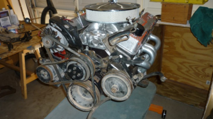

Today, I managed to make my Mercruiser V8 look more like a wanna-B Corvette motor.
I mounted new pulleys, smog pump, alternator, long water pump, power steering and all but 2 of the bracket pieces required to get everthing mounted. I'll need to fab an A/C bracket to use a Sandan compressor and figure out where to mount the other two pieces of brackets I have. It is a bit like a Chineese puzzle. I have 2 hands full of mounting hardware going through the nuts/bolts vibratory cleaner, they should come out like brand new.
Sand blast the brackets, pull the oil pan and check for internal (if any) problems, look for a 700R4 transmission and probably put it in my Hornet Wagon.

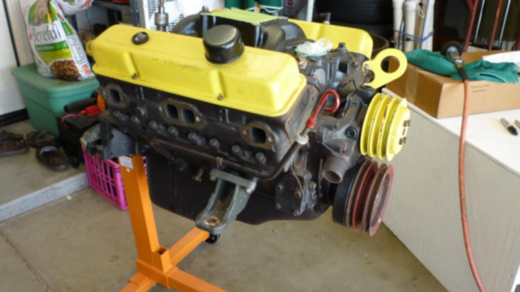

In yellow, I have the Mercruiser V8 as off loaded from my van and placed on an engine stand. In reality is a 350 cu in Chevrolet 4 bolt main engine, I think anyway, I have not got the pan off yet and looked. The casting number says it is 87 through 93 generic, If it is in something, it is one of these. So much for number matching on restoration if you think of it.
In Silver it is now partially disguised as a Corvete Engine. Aluminum Valve covers (in need of polishing) block hugger headers, used almost new., and a belt drive mechanism from what might be a 1985 application 350 with tuned port, of course it might have been a 305 too, don't care. With Alternator, smog pump, power steering and a long water pump. The unused bracket is for GM A/C and I do not have all the bracket pieces but I want to use a Sanden compressor anyway so I will probably fabricate one.
Also an Edelbrock intake in need of polishing and a Carter AFB at about 625cfm.
Today I did pull the pan, but did not count main bearing bolts, I was more concerned about another problem now solved. Everything appears to be in good shape, needs a good cleaning and a replacement for the marine cam. It appears to be a flat tappet engine and that is o.k., A fone call Monday to Iskenderian will solve that problem and the back together with new gaskets, a bolt set or refurbished hardware and a Dupont overhaul of a metalic blue paint.
