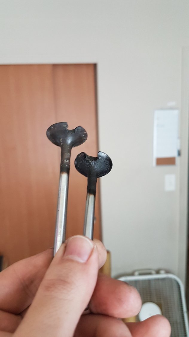

I finally took the head off.
The head gasket on there was, well, take a look. As well, I had no one, but two, in two different cylinders, these messed up guys (and one was in the misfire cylinder.)
Looks like they work perfecty
OEM (Original equipment mangled)
I'm going to go out on a limb here and say I found my problem haha.
And the cheery on top is that my timing chain guide are also broke. (Which could also be reason for my problems.)
So, my car had basically all of the problems.
Luckily the Cylinder walls look nice, the pistons are great (little dirty, but great), I will have to change the valve stem seals (Cause always change seals), but everything else looks great.
This car is going to sign when I'm done with it.
Should I change the valves though. They seem to get expensive quite fast. So if I don't have to get new ones, my wallet would be happy. Of course I need two new ones to replace the broken ones.
The other exhaust are all crusted with crap, but the intake look fine (if not a bit dirty).

I would ring it while the head is off, also replace all 8 exhaust valves. If you really want to stop the exhaust smoke it is rings on the S series cars. I picked and chose timing components on Rock Auto when I rebuilt my last L series L61. If you like the car do it once and drive it out.
Old Apr 14, 2018 | 08:17 AM
  #40
I have to agree with Andy if you're planning on keeping the car. No point in half-assing a job when you're that far into it already. Now, if you're not going to keep it, then pass on the ring job, but definitely replace all of the valves. A new owner at least deserves that.
