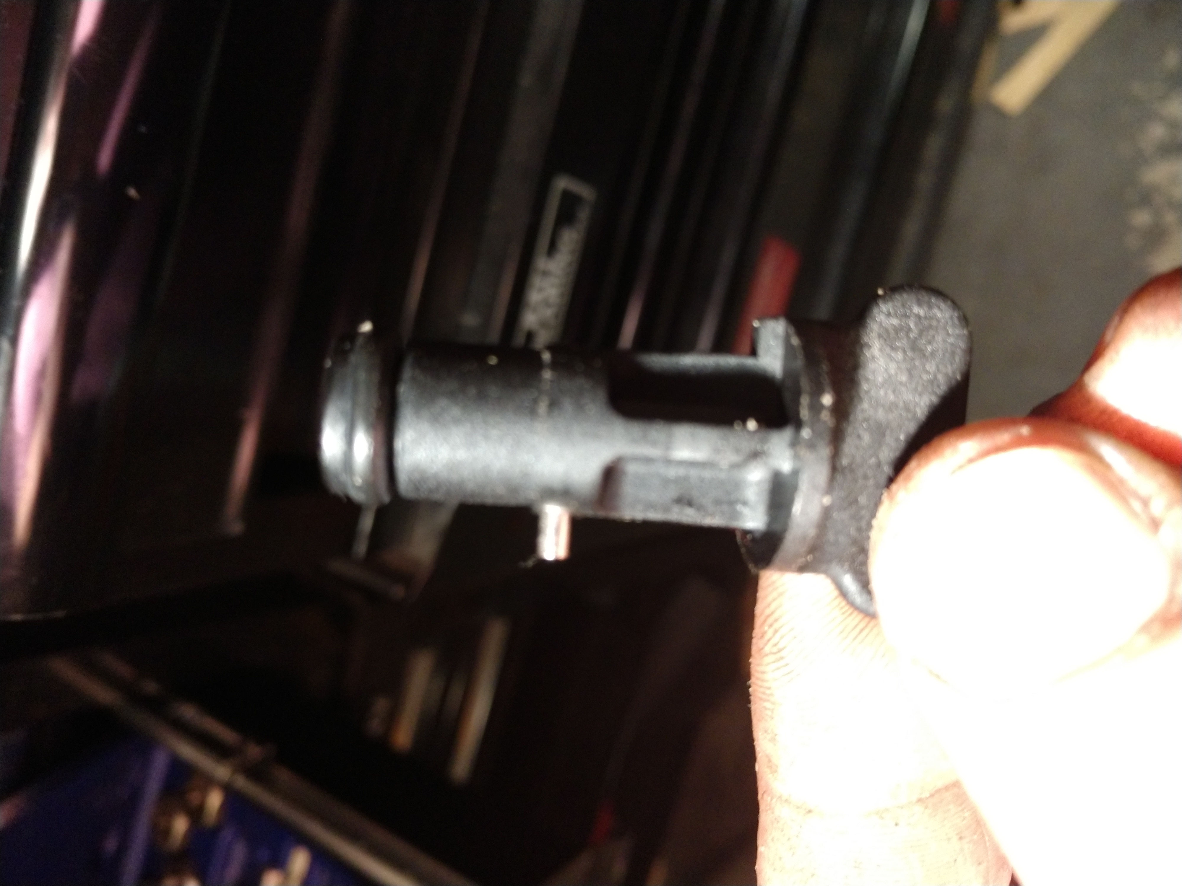

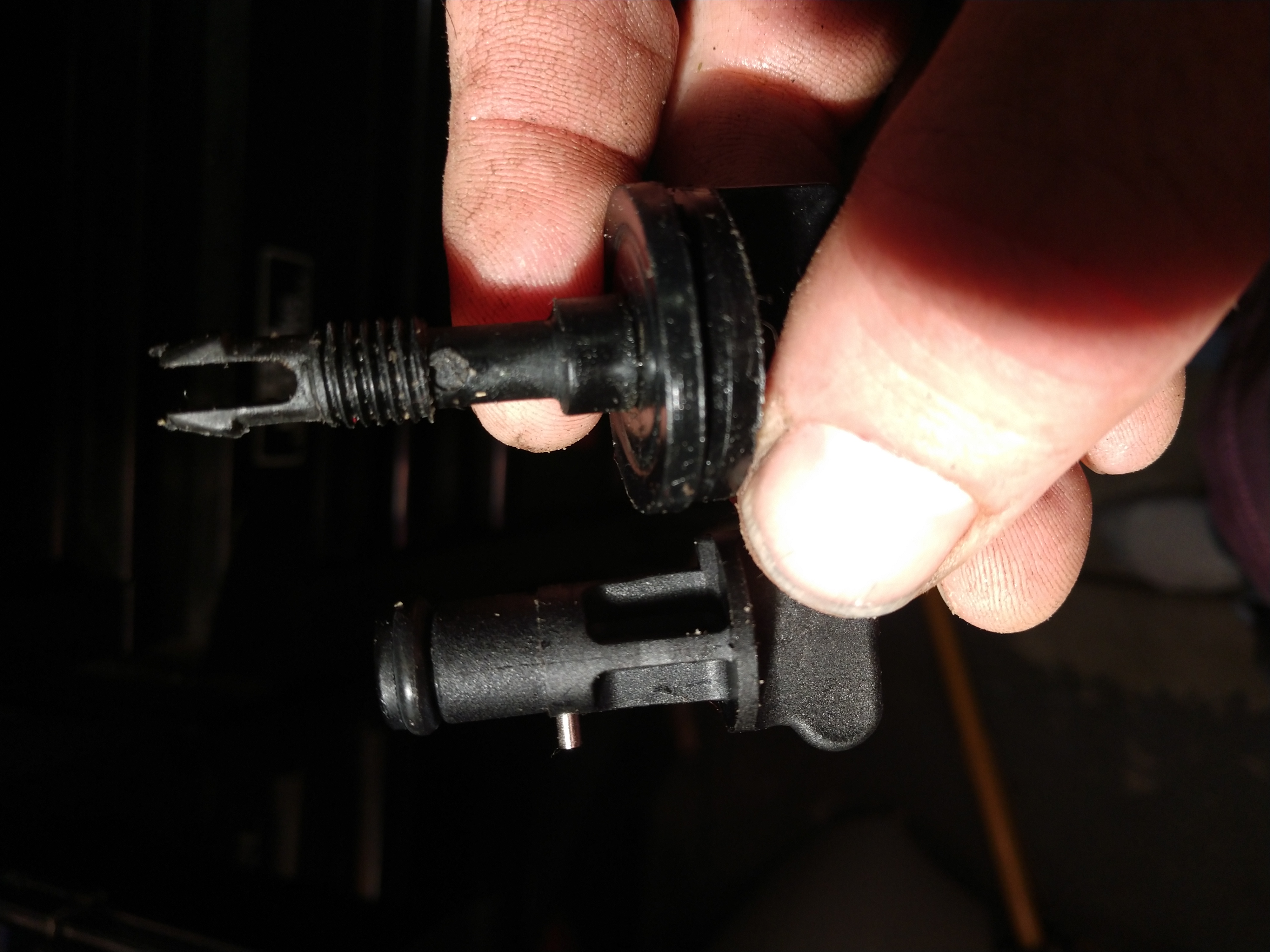

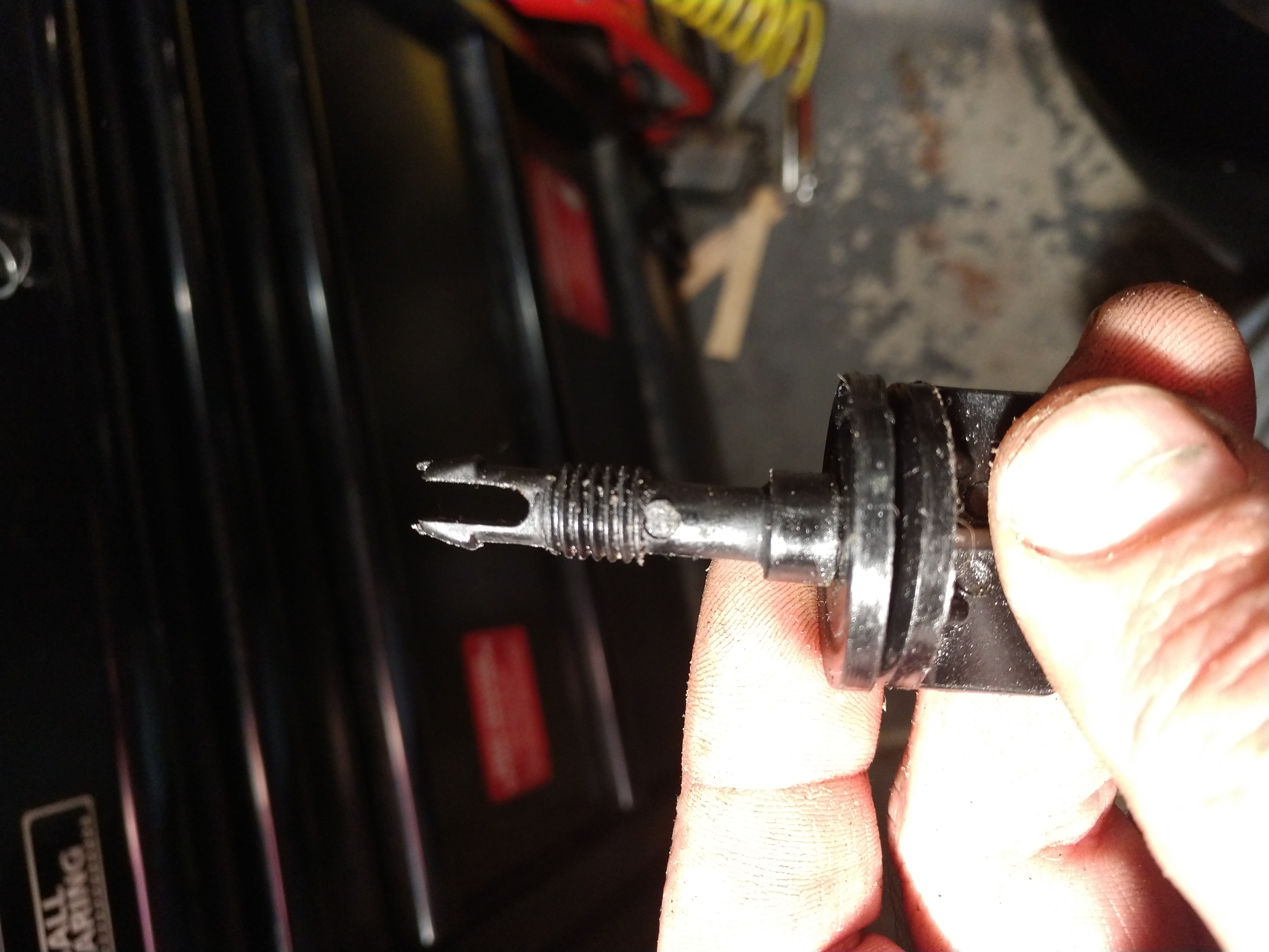

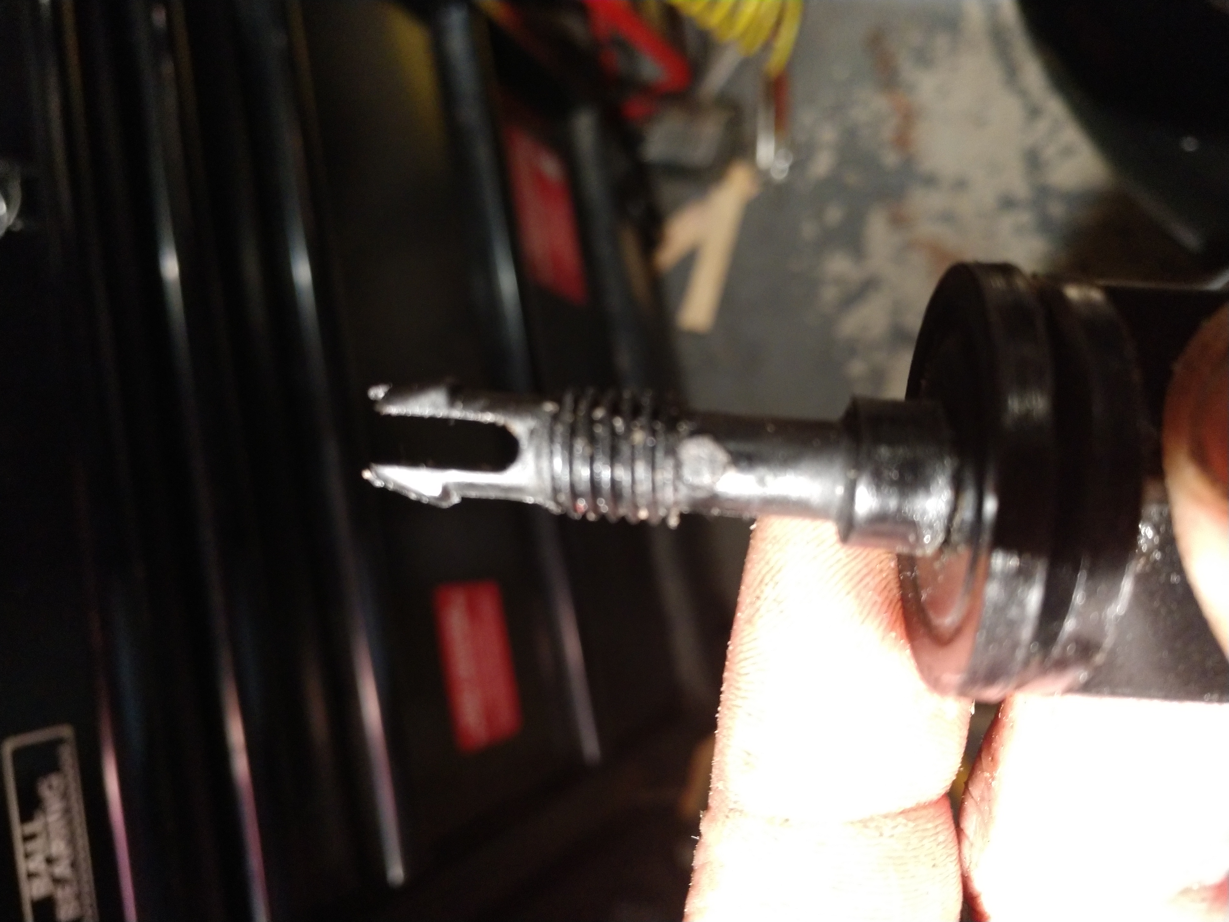

here ya go.
too p.o.d to transfer last night
First two are the piece that came out of the radiator came out of the radiator.
Has retainer as described and the captive threads.
This is the supposed replacement for a 97 S series radiator. It physically can not be inserted and is too short anyway. Aftermarket.
Comparison of the 2. length is completely different.
YES, I ordered the replacement without pulling the original.
YES, that was stupid.
NO, I did not consider the fact that I might have a 1993 S-car radiator in my 97, installed by some local yahoos in NJ I gave a chance in 2010 ish.

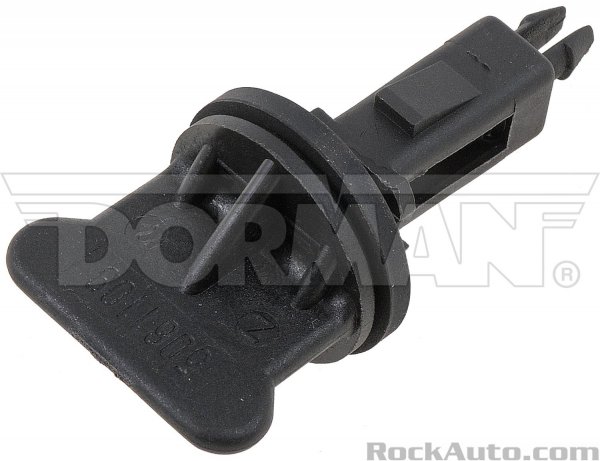

Here is a picture of the radiator plug replacement for a 93 S car (currently available aftermarket.
Same style as mine but with a casing around where the threads are on mine.
a) looks like the rectangular part has retaining nubs.
b) EPIPHANY: The inside of the rectangular piece catches the captive threads of the removable piece. you can only insert that piece once unless you want to break it to get it out
c) Question: Rcctangular part has a slot in the side. Does the coolant drain THROUGH this slot when the petcock is screwed outwards?
That seems possible only if the rod of the petcock itself is holding back the flow (sealing). Seams quite alot to ask with no gasket/o ring.
..............But the end of mine came out slightly BENT, so...........I straightened it before reinsertion -- maybe it wore down being off-center and will never seal properly.
Seems the thing to do would be to
--drain
--remove petcock
--search inside petcock spot for the rectangular plastic piece INSIDE to confirm part design
--Order replacement
--collapse the one in the radiator to pull it out.
Yes ? No? Thoughts?

I have 2 mid nineties Cutlass Cieras that appear to use the same petcock as your Saturn.
Oddly when I search for a replacement ,the only result I get is the Dorman one you found.
I suppose it would be worth trying.
The one with a pin in it obviously will not work for you.
My son has a 96 Impala that uses that type. It goes in a slot and turns 1/4 turn to lock it in place.
Its sad when you cant even find a comparable replacement for a petcock.
