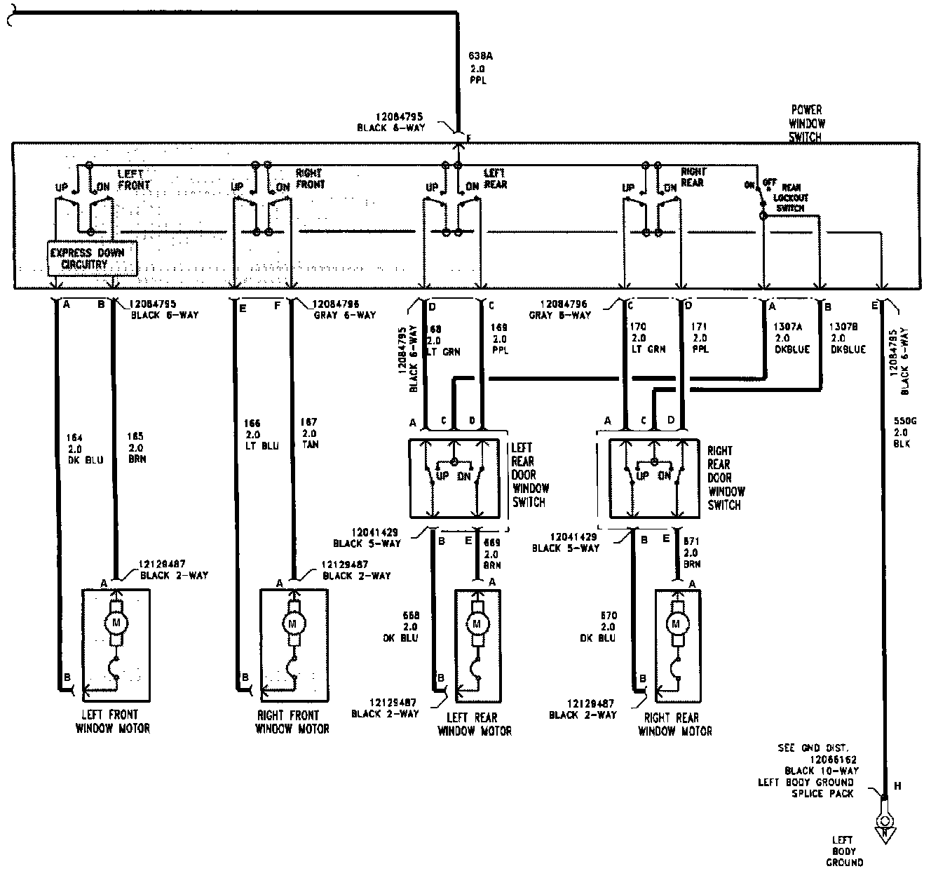

Home >> Saturn >> 1996 >> SW2 L4-1.9L DOHC VIN 7 >> Repair and Diagnosis >> Diagrams >> Electrical Diagrams >> Windows >> System Diagram
System Diagram
Power Windows (Part 1 Of 2):
Power Windows (Part 2 Of 2):
