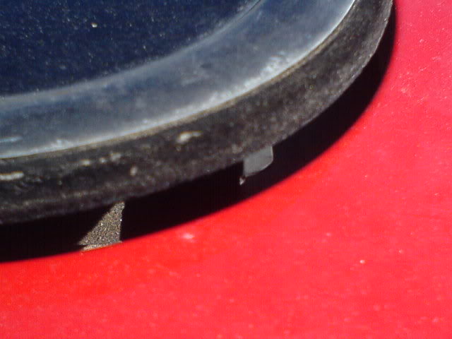

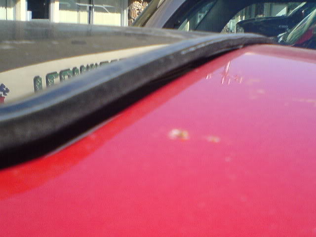

Mine are toasted too... Sunroof just clicks like it's off track (any hints?) and my passenger window goes down but you have to pull at the window at the same time as pushing the button to get it to go up... 97 SC2 btw...

Your track for the window may be dried up (grease is gone) and do the window as a tough time rolling up... spray some silicone lubricant on the track or try to grease it. If this doesn't work then it sounds like your window motor has gone to sh*t and you'll need to replace it. Sun roof clicks?...... don't know if i'm much help 4 that... never owned an electric sun-roof car
Size:  34.4 KBEdited by: GarrenNatas
Old Mar 28, 2007 | 03:13 PM
GarrenNatas's Avatar
Joined: Mar 2007
Posts: 196
From: United States
That's my sunroof after I've closed it... It's been in that same spot for awhile now since it won't open or close anymore... It's annoying but at least it was closed enough to keep the rain out this winter...
