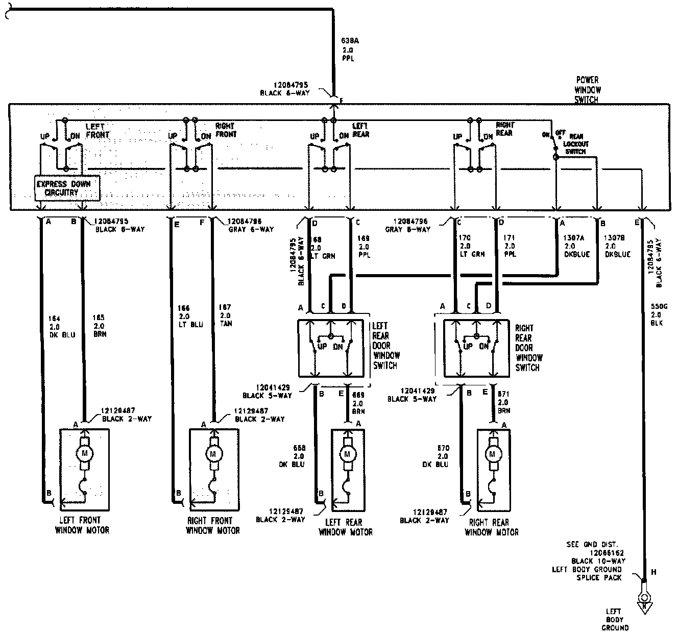

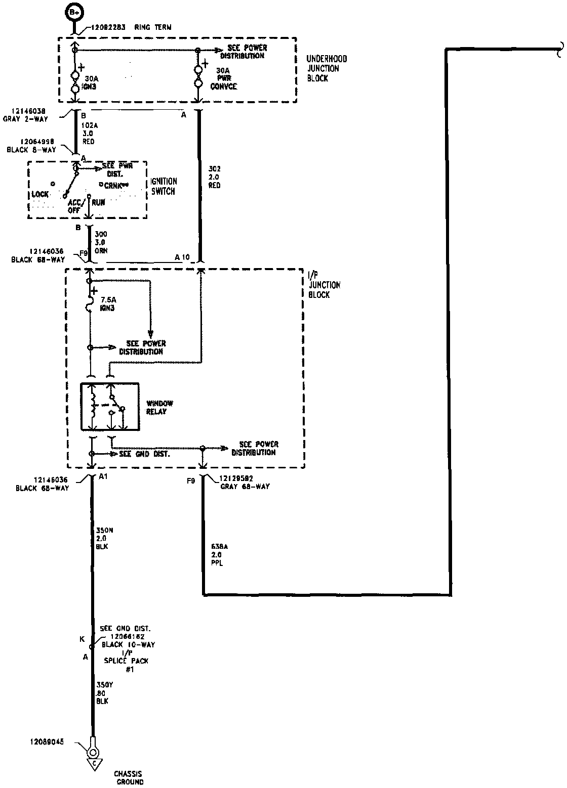

Is there is a single fuse for all power windows (1996 SW2 5 MT)? All windows seem to work except front passenger. Seems I had this issue, some years ago with rear drivers' window since I rarely roll down any windows. except the drivers'...Turns out it was just stuck, though. Thanks
All the windows should be on the same circuit. Does the S car have a master switch on the driver’s door and a single switch near each other window? Or are they like my L which has the window switches on both sides of the floor shifter. My L is a European design with about half of the cars produced with the steering wheel on the other side.
That being said if your car has a master switch of four, does the window in question work from the remote switch? If not you may need to access the electrical connection at the window motor and verify power and ground when the switch is moved. Power and ground will swap places to move the window in the other direction. If the power and ground are good in both directions, tap on the motor. It may be time for a window motor, the brushes do wear out.

On the SW series (at least mine) there are switches for both front windows and both back windows located behind the gear shift, between the front seats. The front doors have only lock/unlock buttons in the doors. The backs have open/close window buttons in the doors but those can be activated/deactivated (to prevent kids from playing with the windows in the back?) by a master switch, also located behind the gear shift.
You're probably correct in that the motor is the problem. But, since I'm not a DIYer, rarely have passengers (and even more rarely need to open/close that passenger window), I can't justify spending the $$ to have the motor replaced or worse yet have it discovered that the problem is a part that has been discontinued.
