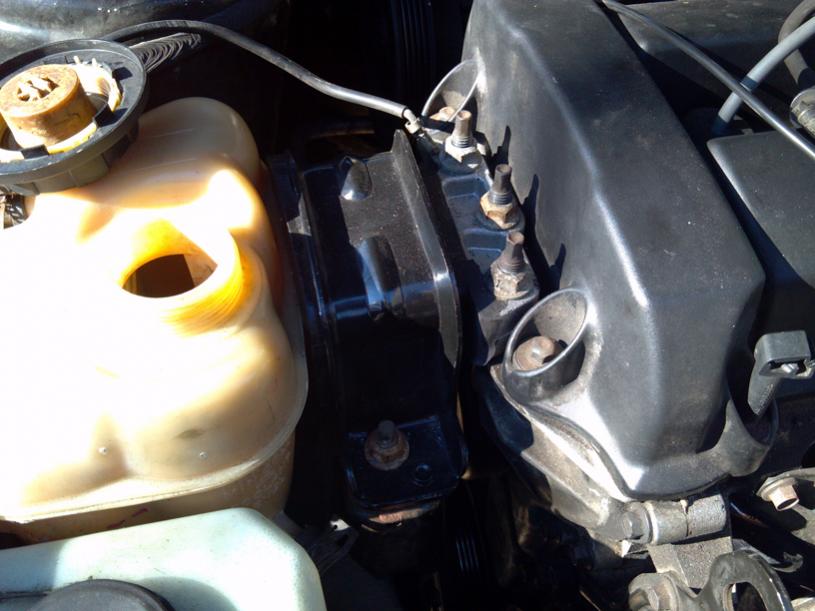

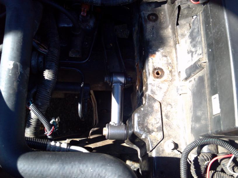

When my wheel hub went bad (around 105 k miles) there was an intermittent knock that only occurred when turning or in certian conditions, until the point of it almost failing. Then when I tried to press the bearing out, the hub broke and sheared off a piece of metal.
also, I have wheel hop when turning all the time, even more in snow and rain. however, the wheel was cut hard. How hard are you turning when this occurs?
a weak motor mount can contribute, there is one behind the passenger wheel that can be worn out, its behind plastic shields so its hidden. If you search on youtube you can find videos on how to see if the mount is worn.
(the pics are where all the mounts are, aftermarket mounts in place. Theres other mounts under the battery tray and in-between the transmission and cradle - which there isnt a picture of)
thats my book worth 2 cents
