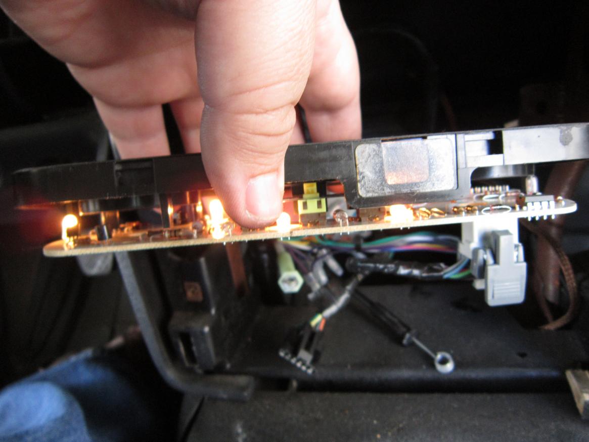

So I opened up the dashboard getting to the climate control.
If anyone's interested in the process for that, here's a link to that.
http://www.cardomain.com/ridepost/63...turn-s-series/
In the end, I had to admit defeat and put everything back together. The lights are LEDs soldered to a circuit board. I have neither the equipment or the talent required for soldering. So, there's that.
In the process of doing this, I found that I had more broken pieces. Fortunately, I can live with them.
Attached Thumbnails HVAC dash module lightbulb out-img_2472.jpg   HVAC dash module lightbulb out-img_2473.jpg
Old May 13, 2015 | 11:36 PM
Posts: 12,390
That is an awesome documentation of a pain in the *** journey that did not have to end in defeat. You could either get a replacement board/AC Head uni from a salvage yard and hope it functions AND has two working bulbs, or pull that board with switches attached and find an electronics repair shop to solder it for you. Just check the voltage across it so you know what to replace it with.
