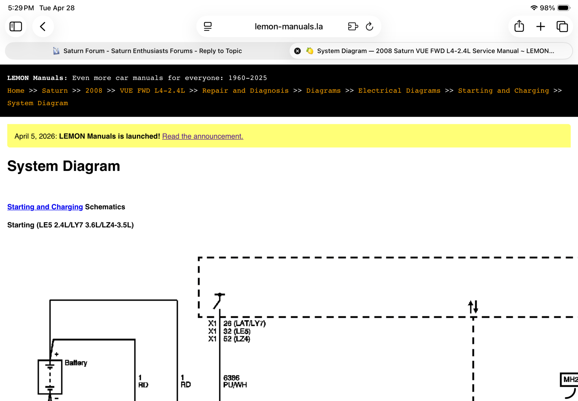

Do you have a code reader? If so see if it will communicate with your car. Tell us what you find please. The car has a body control module that just about everything electrical runs through. I looked a few circuits that you reported as not working and they all run through that module.
The horn is not a BCM function.
The wipers run through the BCM.
Here is the main BCM schematic.
Here is the link to the manual online.

i do not have code reader. i think auto parts stores still let you borrow. i will check each connector on module and voltages
