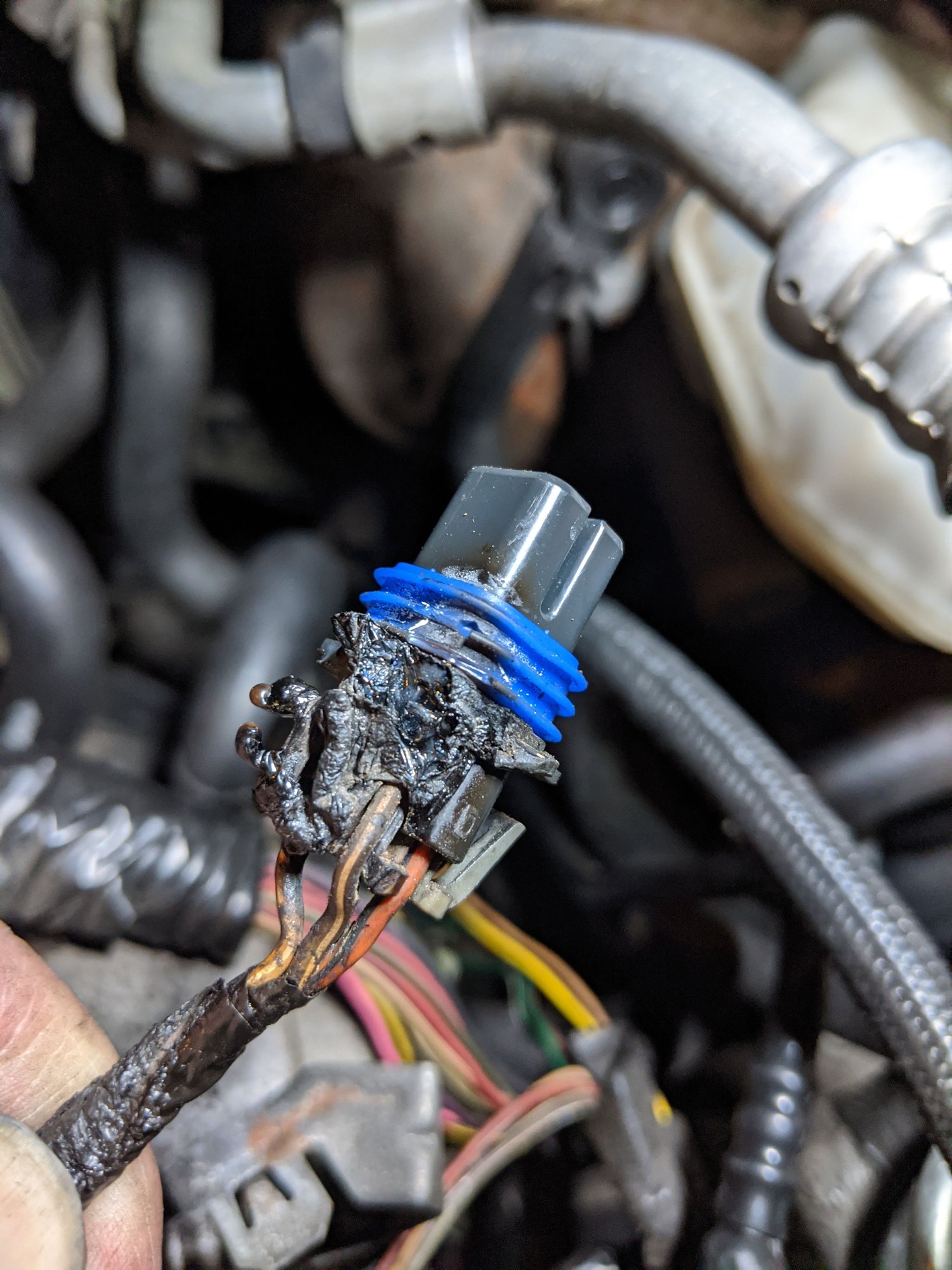

The wiring harness for that O2 sensor got tucked up under the heat shield. I'm sure I did that with all the work I was doing, replacing the engine and all.
Anyway, the plugs were melted together. Nice.
looks like I got some rewiring to do...
Old Aug 8, 2020 | 08:42 AM
I'm sure pigtail is available for that...somwhere
