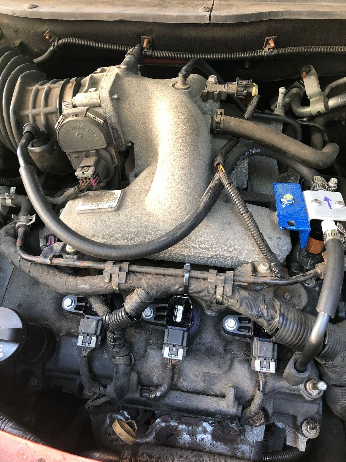

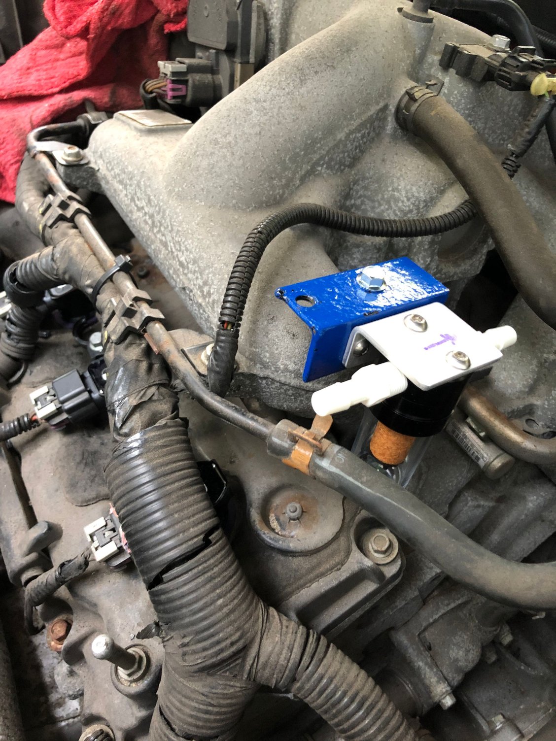

Done! Replaced plugs and coils; and installed the air/oil separator. Check engine light is no more; also reset the maintenance light, which I forgot to do after the last oil change.

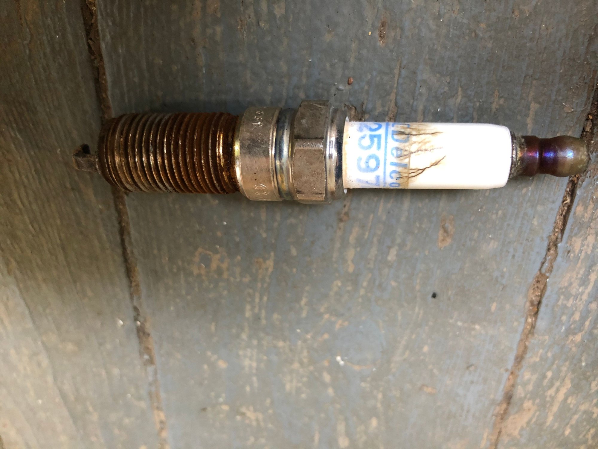

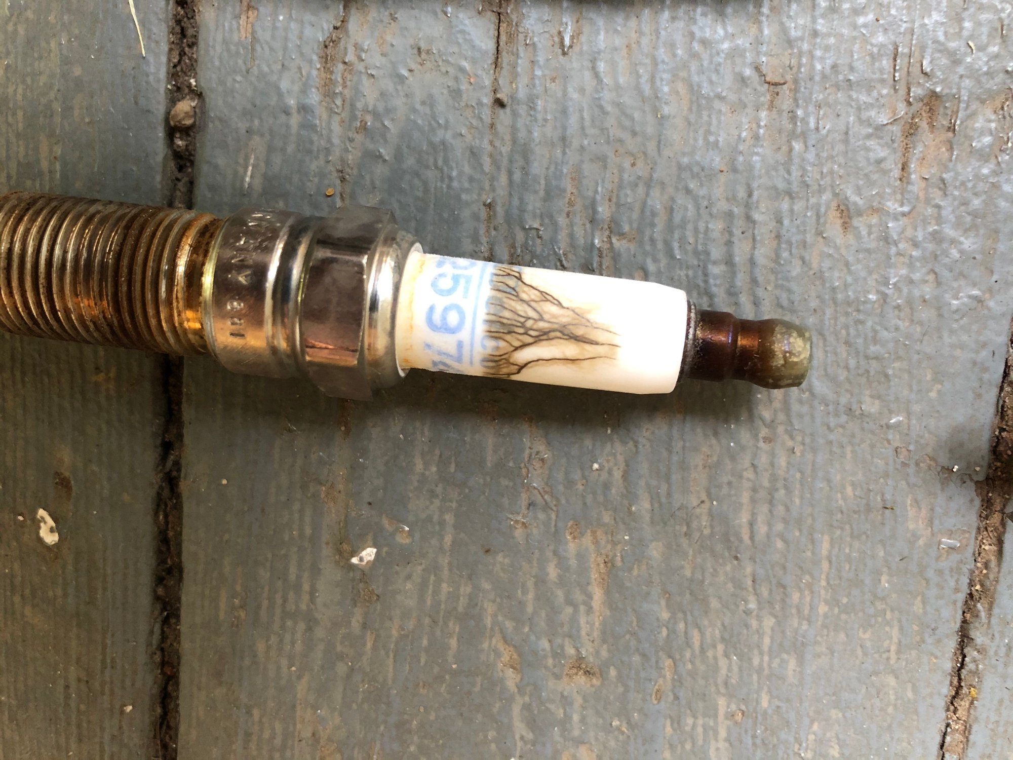

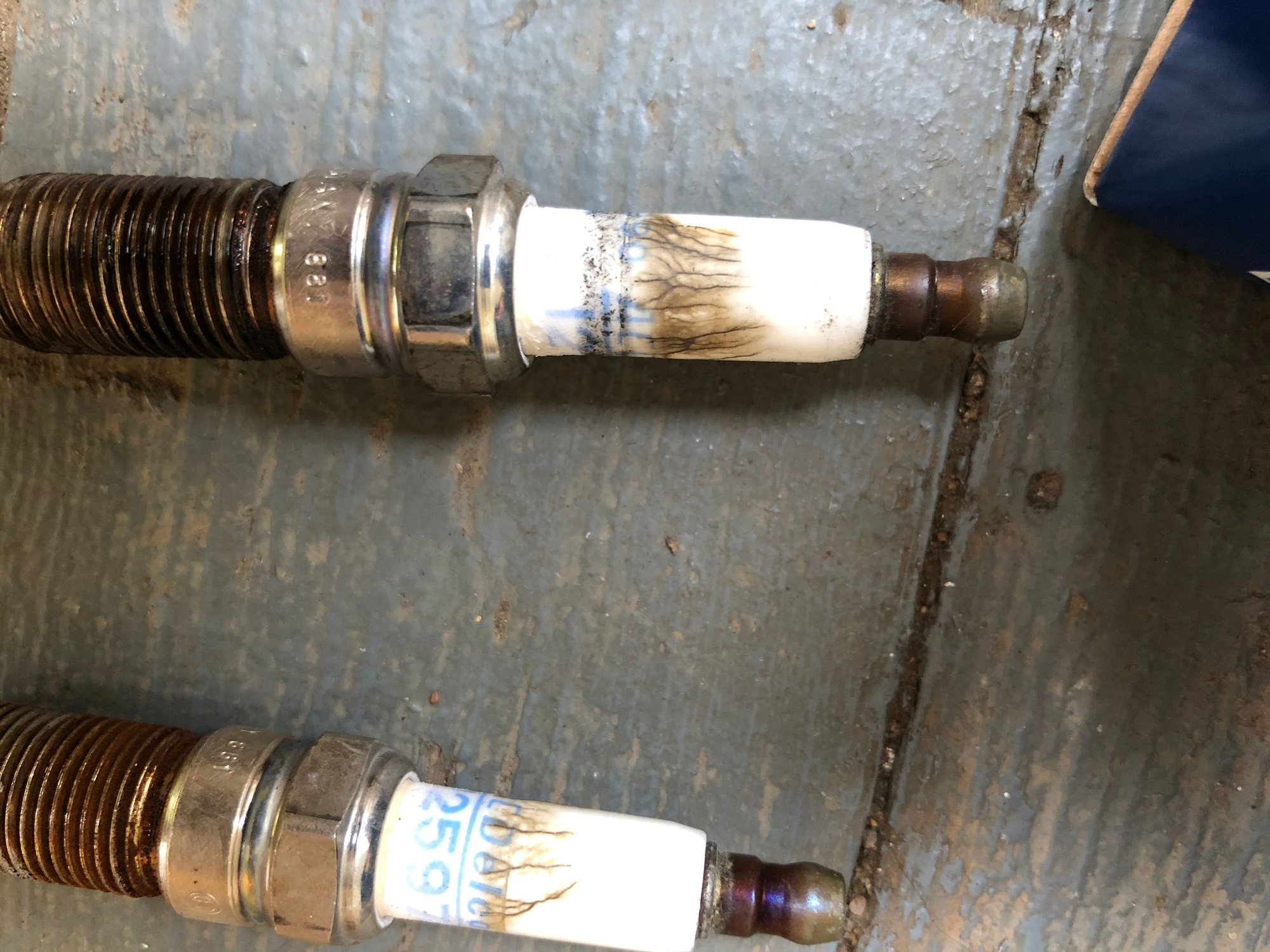

I had a few plugs that had cracks in the porcelain. Are these cracks big enough for the charge to go through and cause a misfire? Other than that, the electrodes looked good; just old.
Old Jul 21, 2020 | 08:54 AM
Are you sure those are cracks? Looks more like arcing to me from the plug wire not being fully seated on the plug. IDK, just guessing. But if they are cracks, then yes, that would cause leakage and misfiring.
Old Jul 21, 2020 | 09:27 AM
Chickenbone's Avatar
Posts: 401
My nail gets caught in them; but I guess is could be arcing. It took a little effort to remove the coils; though it could be that one of the terminals was loosing contact. I still have the old plugs and coils; so I will inspect them a bit more.

My aunt came over late last night so I was only able to check fluid levels and take a look at the oil/air separator. It has been 2 weeks since this was installed and was pleased to find a tiny amount of oil in the catch basin; so at least I know it's working.

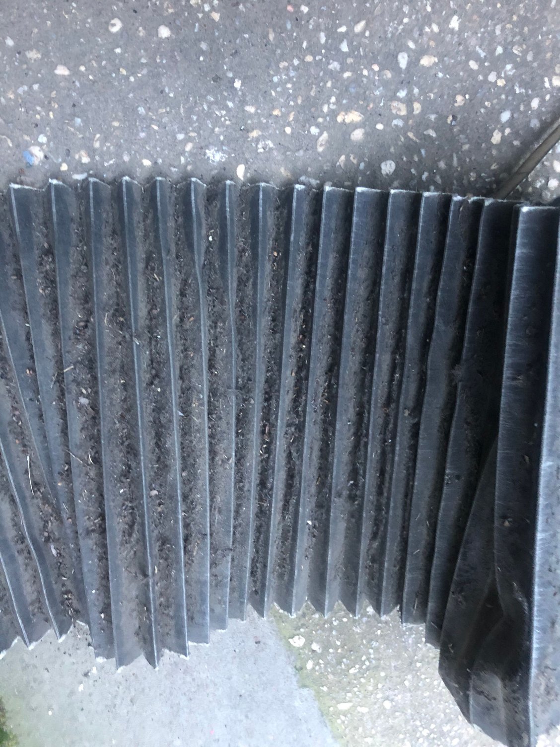

As such, I found a picture on my work phone of the cabin filter that I pulled from the Vue late last year. I forgot how nasty it was. I will check the owner's manual and verify the replacement frequency of the cabin filters.
