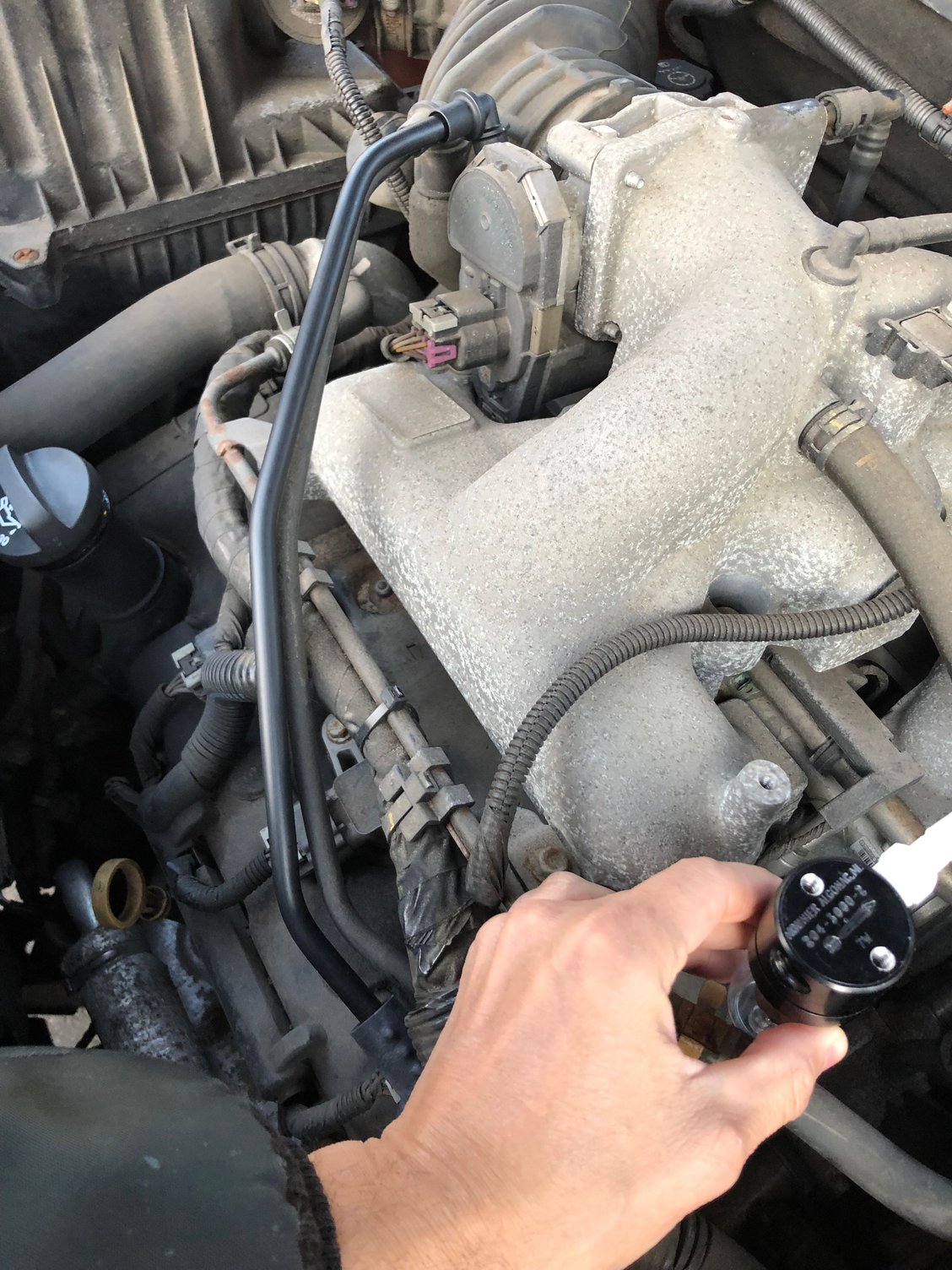

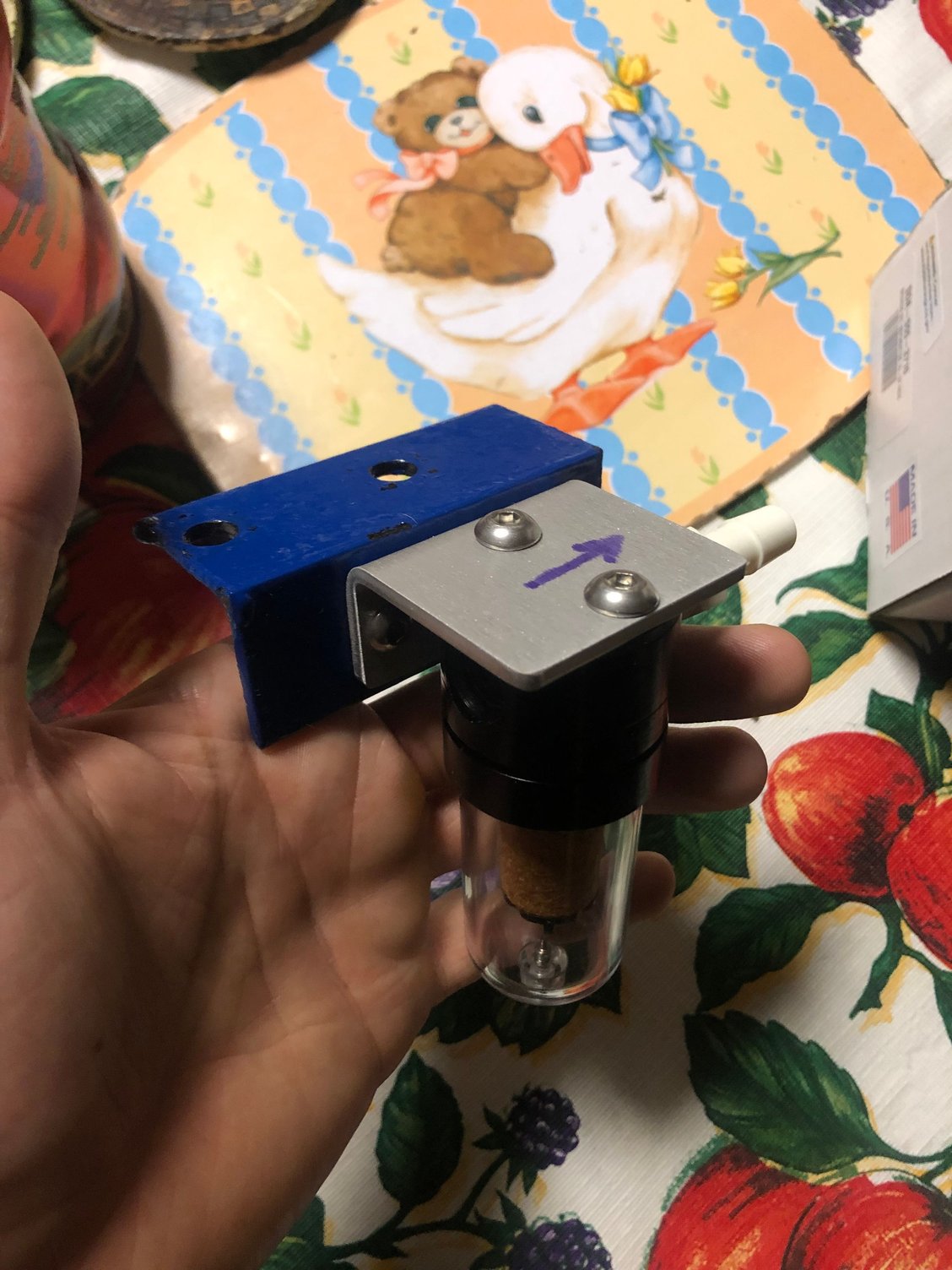

So I got a little time this weekend with the Vue. I took pictures of the engine sans the engine cover. I purchased the PCV AC Delco 12601254 hose and I am going to use the Steeda oil/air separator that was going onto the Crown Vic. Also going to use my reject throttle cable bracket to mount the catch can. Next decent weekend, I will mount it and plumb it all in.
