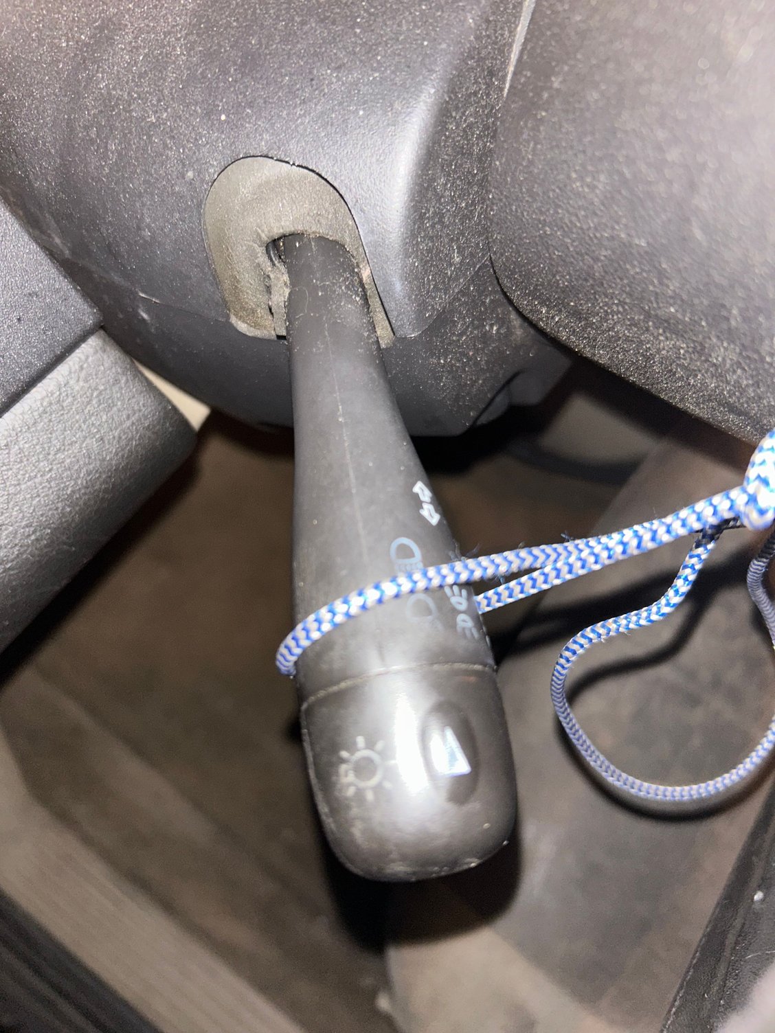

And with the keys out of the ignition it still reacts the same way. I am going to the junk yard tomorrow to see the same model/year Saturn to see if I could find something and get some wires for the horn to splice and just to get an overall better visual of what might needs to be done without potentially damaging my actual Saturn lol
And I did that as well it’s the same response. I just don’t understand the power loss and why it’s now affecting the left side front passenger headlight too ,i understand I have to check a the wires more can do more troubleshooting/testing , I just can’t see where I could have messed up to make the passenger headlight have issues when just two days ago it was fine and now reacting the same way as the driver side , the only way the headlights work is if I’m pulling forward (as if I was flashing the high beams)
the switch by the wheel inside the car and holding it and all the lights (parking light, low beam, high beam) turns on both sides still only in the front , back has no issues
when I have it in auto none of the bulbs light up and when I turn the headlights on all bulbs don’t work on both sides , the high beams don’t stay on neither only if I’m physically holding that switch do all bulbs work both sides I’ve never had an issue with the left side. So this has definitely became a bit more of a challenge lol hakkuna mattata right?! lol

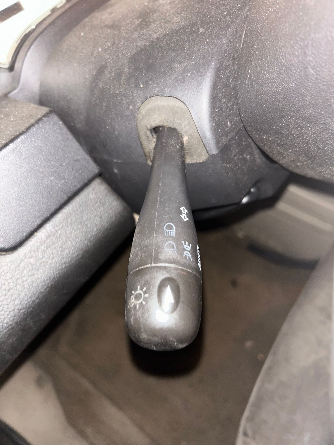

That’s with the switch being pulled forward (as if flashing high beams ( the keys are completely out of ignition and in my pocket lol)
Position switch is in

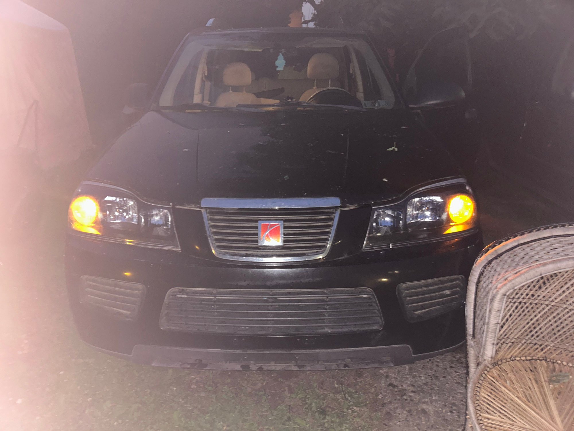

Headlights how they are with switch being pulled

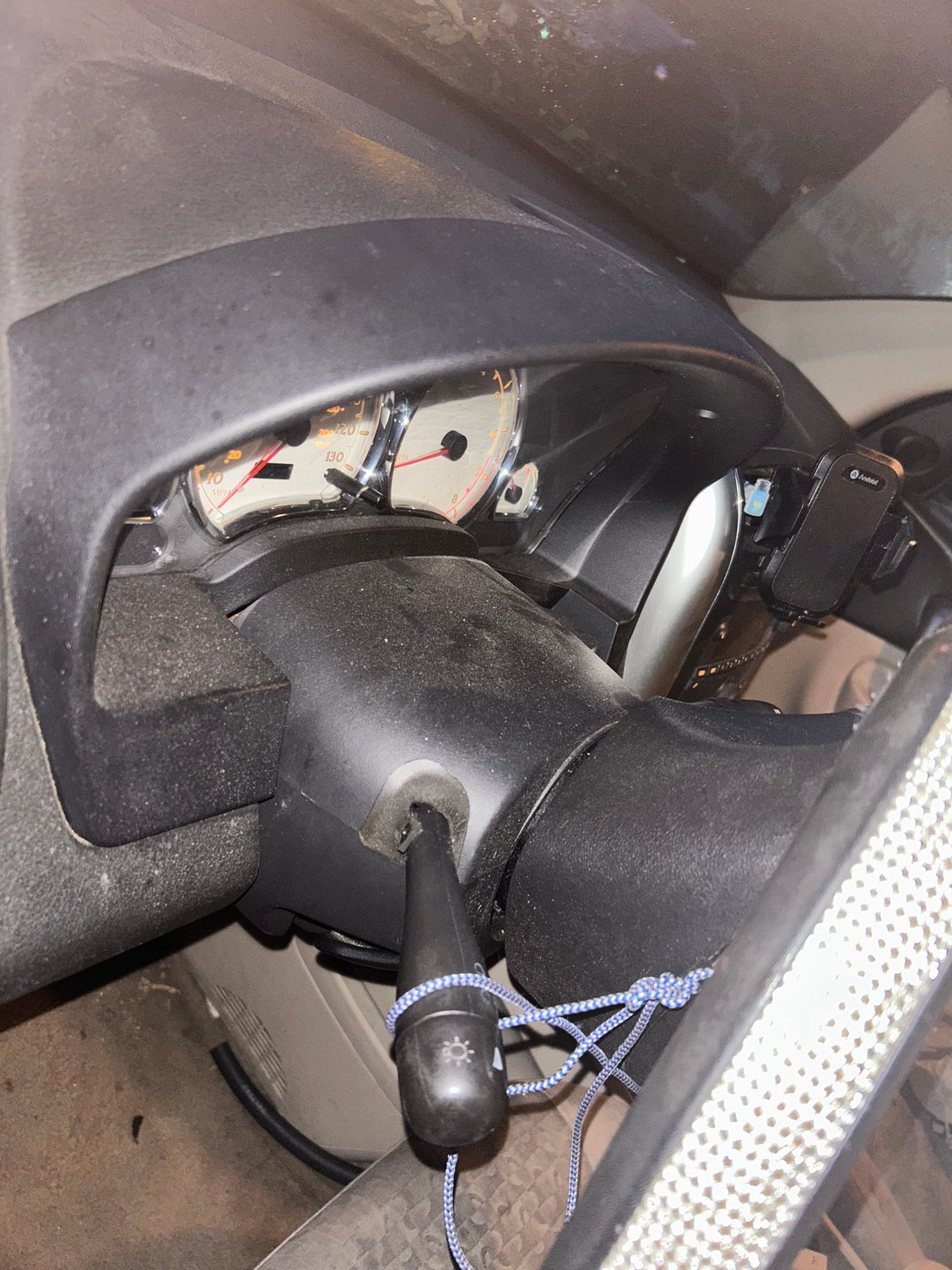

Switch released with same position as it was held

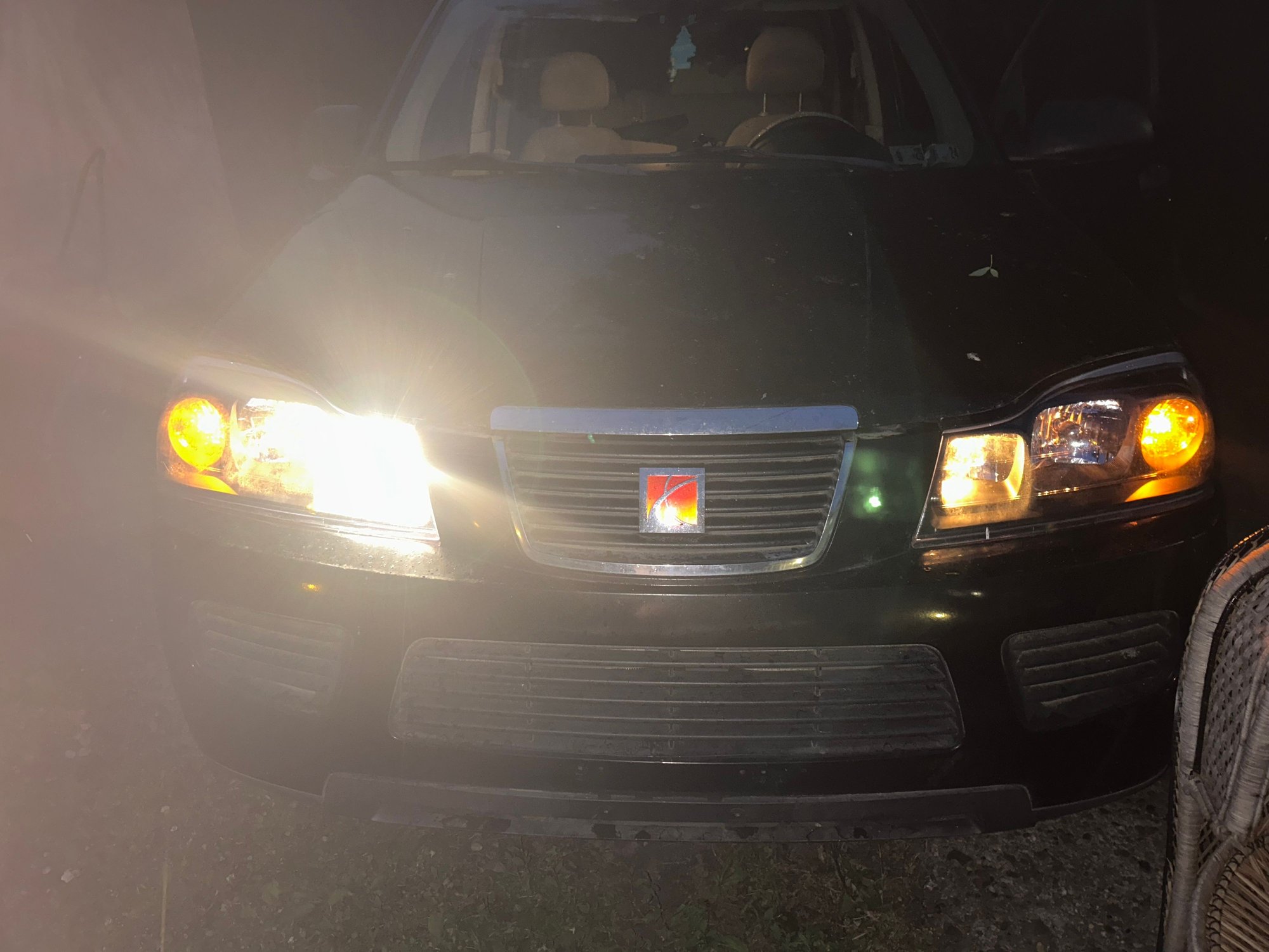

Headlights how they are with switch released 😕
