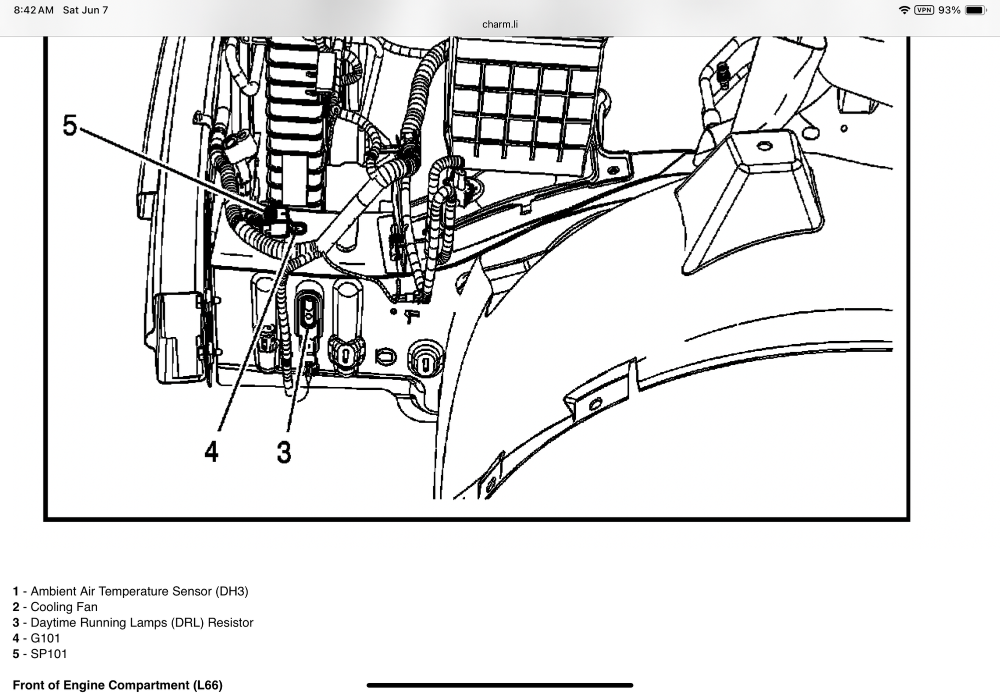

Looks like there is a major ground splice pack just behind the driver’s headlight. I would start there. Here are a couple drawings of the location, it is bolted to the top of the frame horn and you should be able to see it under the hood. It is G101 in these drawings. Please unbolt and remove the plastic cover, inside you will find 12 small black wires on a metal bar that has one bolt hole. You will probably find some corrosion causing high resistance. Please post pictures so we can continue.

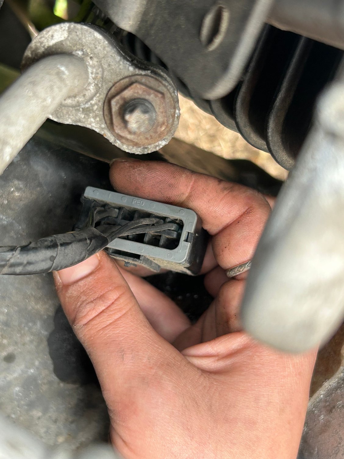

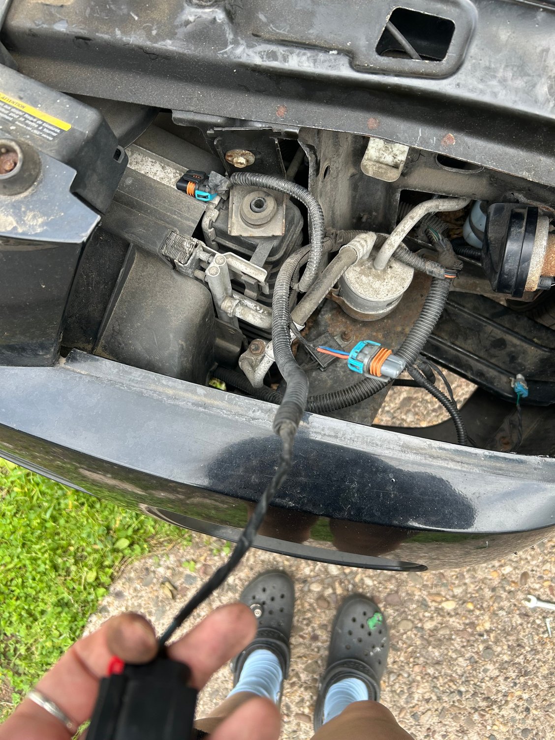

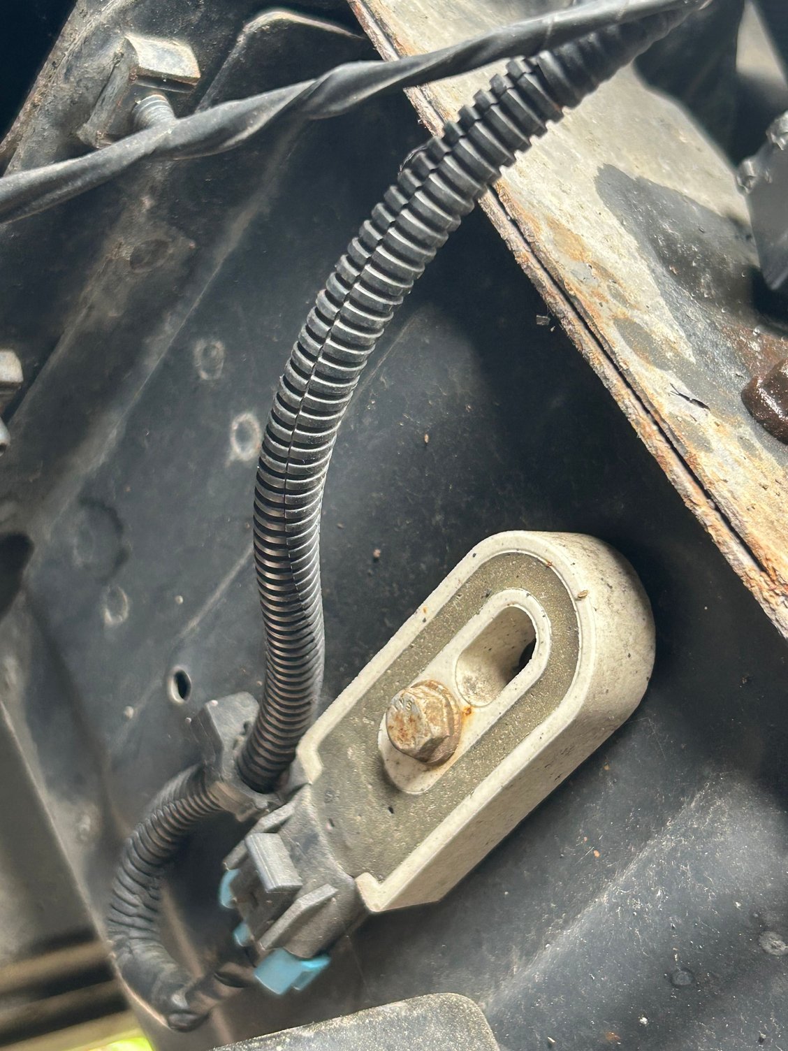

Hello so the weather has cleared up a bit this morning and I think I have unbolted G101 shown in picture below if not atleast I have a bit more access today to unbolt or uncover what needs to be and I tried out the hazards and they don’t blink slow
I opened the cable covers and the cables themselves don’t look bad I did not unwrap the electrical tape around the ends that are in the connectors but they look pretty okay too

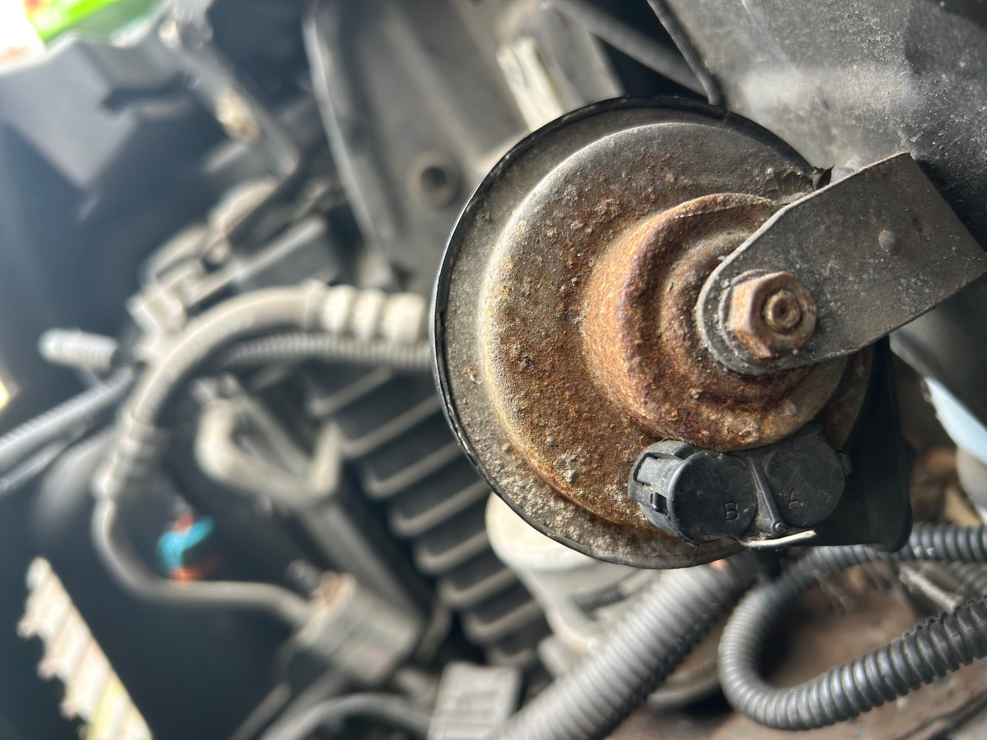

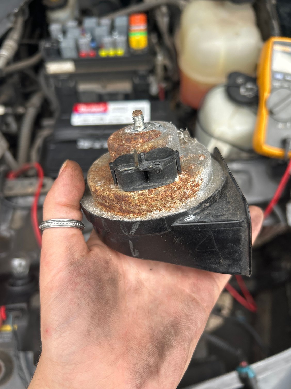

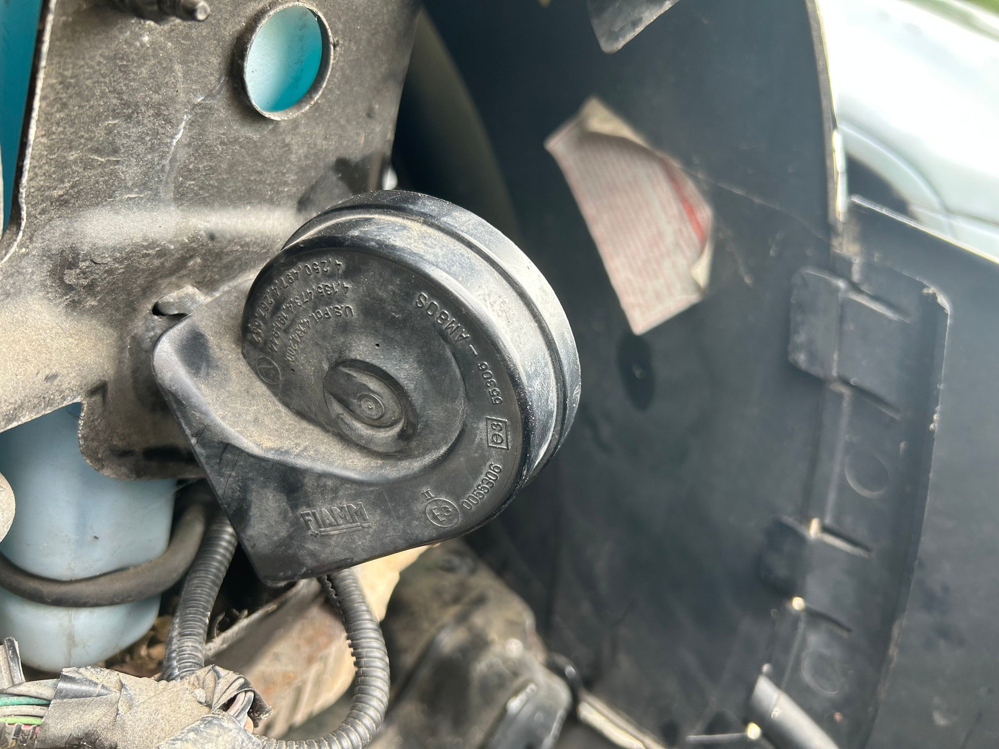

Front of the horn
Front of the horn
Back of horn , I do see the (A,B)  sensor/connector is broken

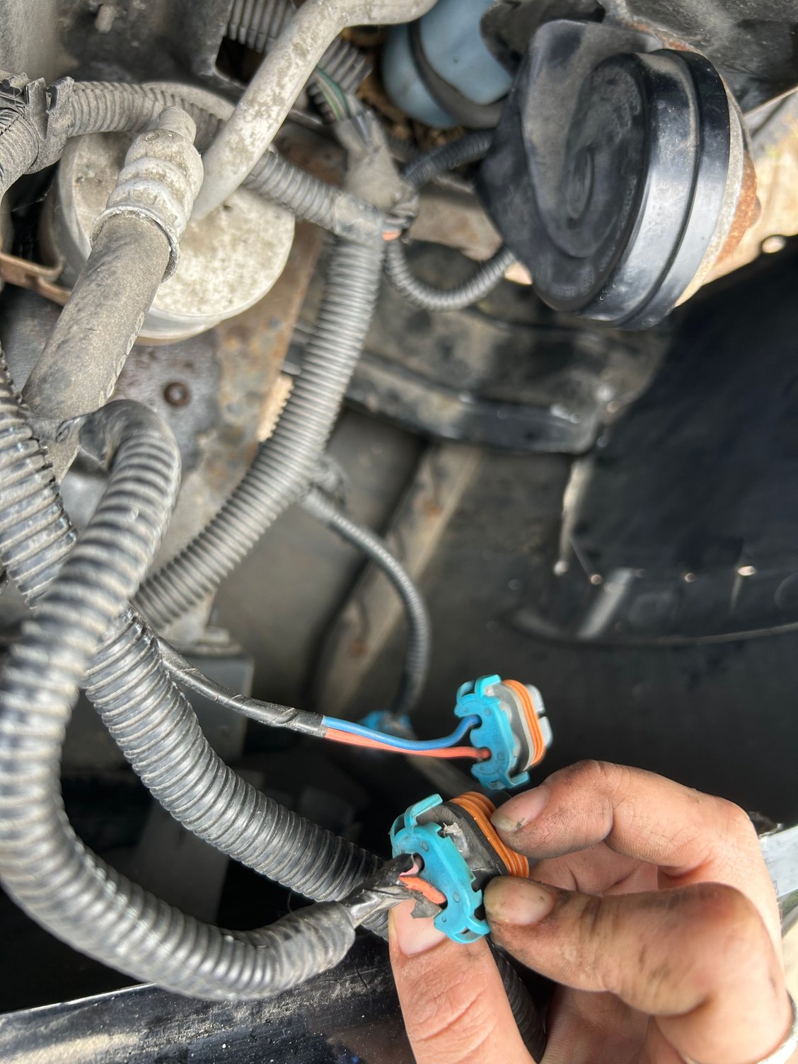

Turning signal connector in my hand and over view of headlight wiring

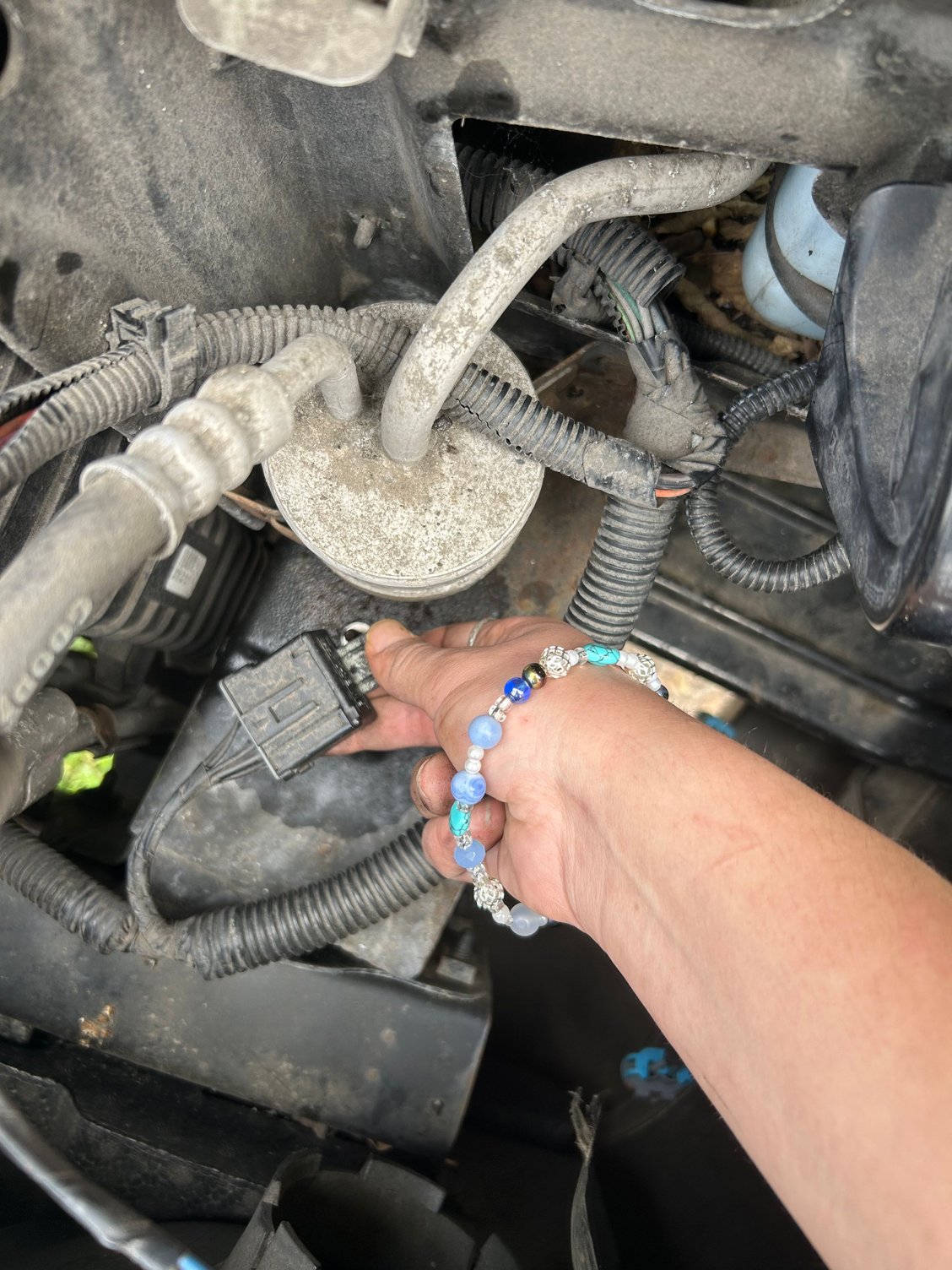

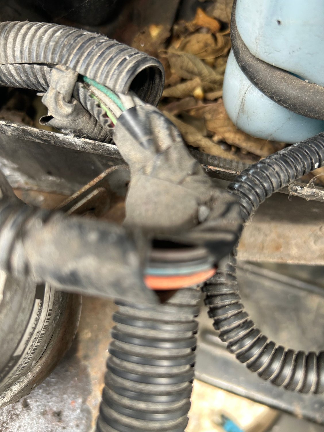

Connection part of headlight wires going into more of the wiring harness behind frame horn going into fuse/relay box
Connection part of daytime light, fog light
Wires into the connectors for low beam and high beam

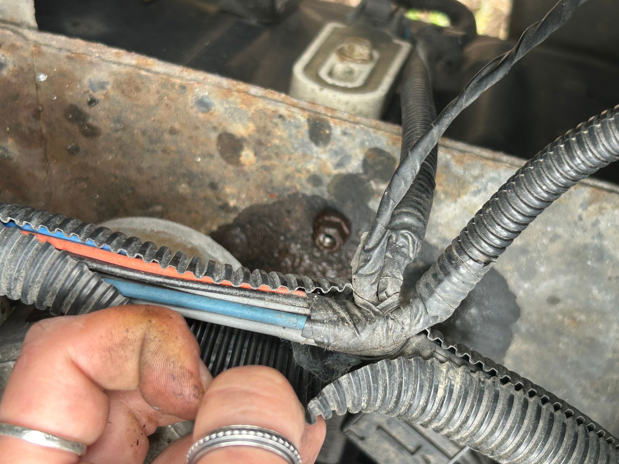

What I assume could be the splice rack for the wires ?
Wired into assumed splice rack

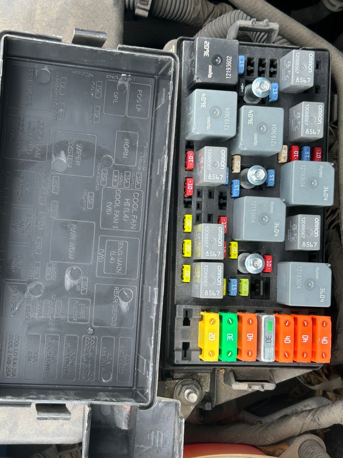

Fuses/relays for under hood next to the battery terminal

You are correct, that is the splice pack. Can you remove the plastic cover? Each black wire attaches the steel piece that bolts to the car. The corrosion I found was at the connection under the plastic. One of those black wires is the ground for the horn. I think if you can release the gray cover from the black plastic the black part will slide over the bolt down tab.
Old Jun 8, 2025 | 10:49 AM
Your turn signals and running lights ground there also. The headlights are a completely different setup. You will be able to check resistance between the splice pack and the turn signal wiring with your meter.

Are the wires still connected to the horn. Plastic can be broken if the wires are still connected and not crushed. The two wires cannot touch bare wire or a fuse will blow. One of the wires gets 12 volts when you press the horn and the other one goes to the ground splice.

The headlamps functions are controlled by the body control module. That being said the high beams are controlled at the same time by the BCM. If both headlight fuses are good both are controlled the same and are grounded at the same spot inside the car. So if one high beam works correctly then so should the other. You will need to open the harness and look for a pinch point from the previous body damage.
There are connectors on the underside of that fuse panel that the headlight wiring runs through. Both in and out. We can walk through ohm checking the front harness but it would probably be faster to uncover the wires and look. Is the fuse panel on the driver’s side? If so the damage may be under the fuse panel.

I have been struggling still trying to access the wires in the splice rack. I was able to get out the grey piece but the black piece that’s supposed to slide was not budging and I don’t want to damage anything with to much force
now we have a different issue when I disconnected the splice rack to try and access the wires I reconnected it after having a bit of trouble completely accessing the wires. And tried to reread the voltages coming from each light connector they all had off readings

the horn doesn’t have any visible wires/connectors connected to it and almost looks melted at a bottom point.
I tried submitting a video of the lights in 30 second increments and it’s not allowing me to, but I do have a video of how the lights are preforming.
Horn , nothing was plugged in and I cannot find the correct connector in the car meant for the horn
