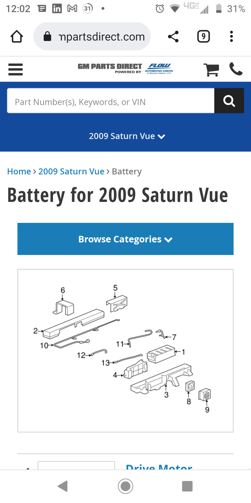

All screenshots captured from www.Gmpartsdirect.com
2007 Vue, assume green line.
2009 just referred to as hybrid
Parts listing in middle of page. Note that descriptions next to other components state for Malibu, aura,... Not the Vue
Supposed battery for Vue Green Line
Fitment shows only 2007 Green line Vue
2009 Vue
The 2009 Vue is a second generation Vue. 2007 was first generation. Many many changes.
Fitment information is confusing. Lists the other battery pack configuration that was originally listed seemingly only for the Malibu. I've included the main page and the fitment for the part in question. The table shows it appears in both the 2007 and 2009. However, the first part I specified above shows only a fit for 2007.
I know nothing about hybrid battery packs. Maybe they did away with the need for the first one I specified for the later models.
Then it becomes a question of which one do you need in the 2007 to be replaced?
The correct answer to this is waiting for you at your local Chevrolet dealer. Bring in your VIN number and they can give you information much faster and much more accurately than I can. Even if the parts are discontinued, you can determine what the correct part numbers are for what you need.
Supposed battery pack for 2009. Also appeared in 2007 search label as for Malibu
Fitment indicating 2007 and 2009 use this part. Does not appear part specified for 2007 above is used in 2009.
