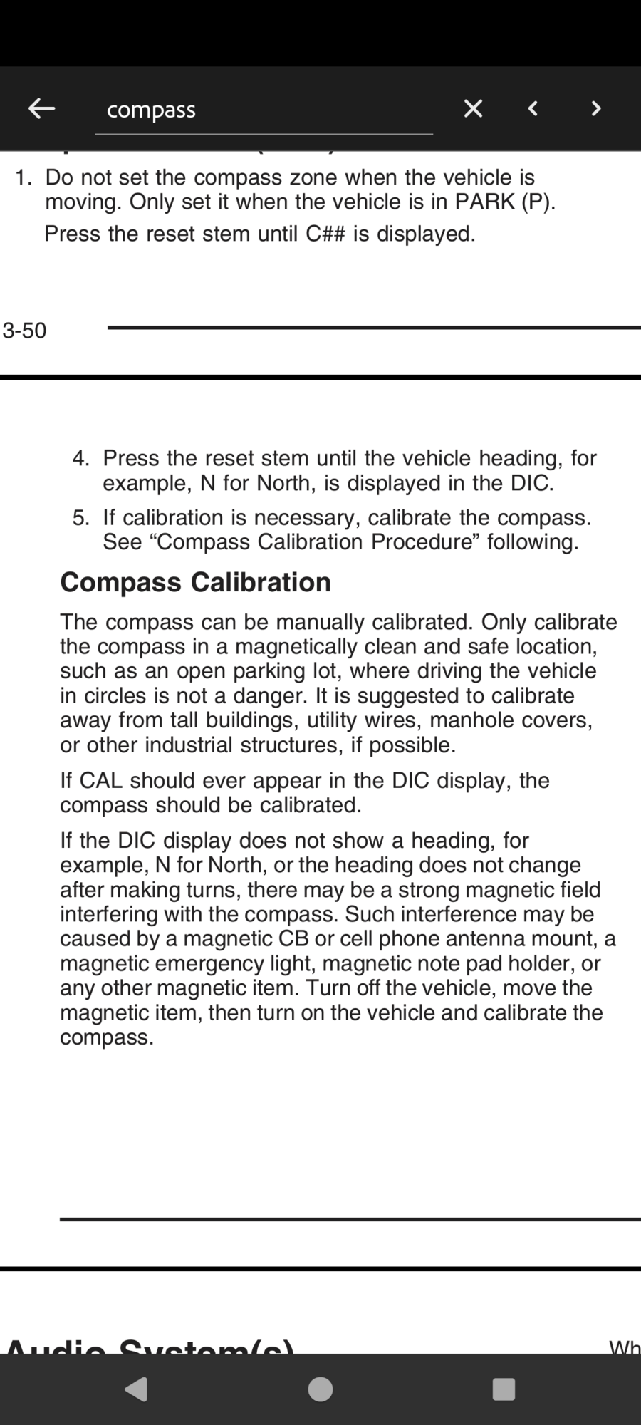

Old Nov 14, 2024 | 08:02 PM
From the 2008 VUE owners manual:
Since it is not showing a direction, there is likely a strong magnetic field interacting with it. I'm willing to bet it is a magnetic mound for your cell phone or a wireless charging pad attached to the instrument panel or the top of the dash. Unfortunately, I have no idea where the actual compass is located within the vehicle, so this is where my help ends. The manual also has directions on how to recalibrate it once you get the magnetic field to stop interfering with the compass

Hmm, I just got a copy of the owner's manual and found the Compass section. Thank you, I'll try to find an open field somewhere outside of suburbia, lol.
Old Nov 15, 2024 | 12:55 AM
It's more likely to be a strong magnet in your car like a magnetic phone mount that holds your phone or a wireless charging setup which creates a large magnetic field in order to induce a charging current in the battery.
If it never indicates direction, it can't be the entire area in which you drive. Look inside the vehicle for magnetic things as mentioned above
