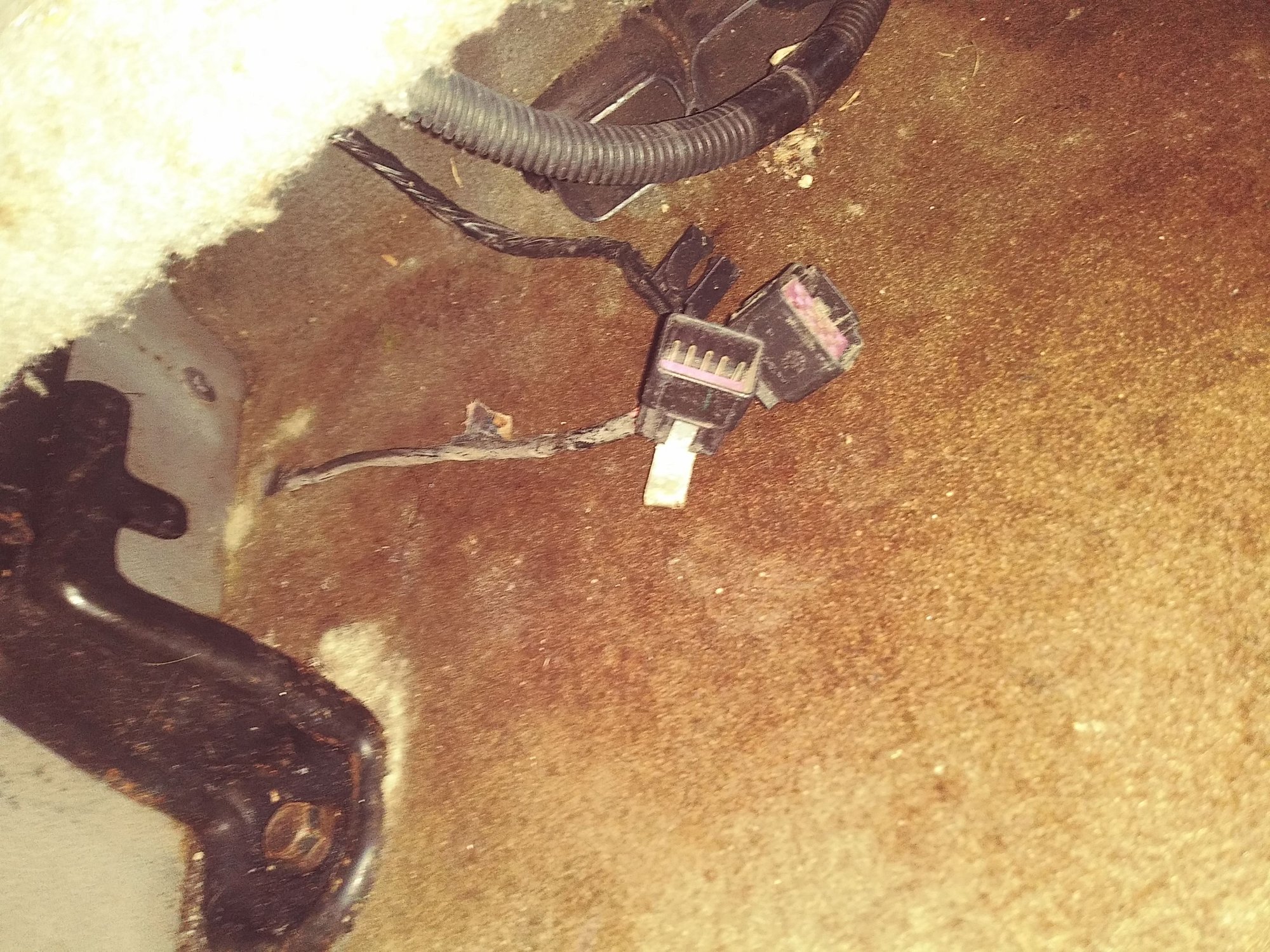

I have an 07 Saturn Vue 2.2l I4 ecotec auto suv I just bought and I found these two connectors under the front passenger seat anyone know what they're for? I can't find any place for them to connect to. Here's a picture
This picture is oriented from the back passenger door under the front passenger seat. I don't know what these two connectors go to if anything.

Silly question, but where are they coming from? The frame of the seat? Popping up out of the carpet by the center console? Do they look OEM or aftermarket?
Old Dec 7, 2020 | 08:33 AM
The L series cars come wired for electric heated seats, only some cars have the heated seats. Might be an option your Vue does not have.

They seem to come from the center console and they look oem. They don't look like they've been hooked up to anything for a long time if at all. I guess they could be for heated seats. I dunno

Whats the center console look like? Seats could have been swapped out at some point.

One of them comes from the side of the center console the other comes off the side of the bottom of the seat. There's Also two wires connected under the front of the sea
Threes the two connectors and the one is going under the center console
here's the other wire going to the left under the seat. It's the thin one
Here's a better view of the entire wire from connector to the seat.
Here's theother two wires that are attached under the front of the seat.

Looks like one is male and the other is female, and they're the same general shape. Do they plug into each other?

They go together and when i hooked them together my airbag light shut off. Thanks. When i looked before i thought they both came from the center console and never even thought they went together.
