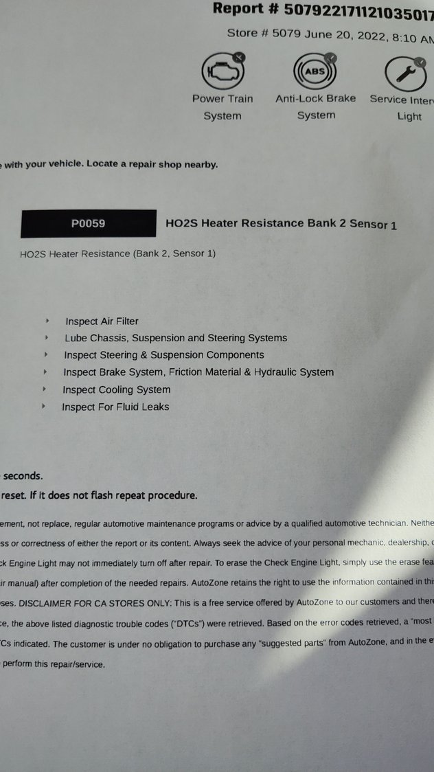

Hi guys.. could use some input here if anyone has any ideas. After driving 60 miles im getting P0059. Pulled the battery cable for a few hours and drive again, same result. I already did BOTH 02 sensors... any ideas??

Check here for a discussion of this code: P0059
It says it's usually bad O2 sensor, wiring or connectors, fuse, or ECM. You've already replaced the sensor and the fuse (check the fuse again), so you'll need to inspect the wiring and connectors thoroughly. If you can't find anything there, get a good diagnostic technician to check before you spring for another ECM.

UPDATE - i found the OEM sensor for 38 bucks on RockAuto but this is confusing..is my issue the upstream or downstream sensor? All the articles i read are EFFING confusing..

First, it could have been a shorted sensor that blew the fuse -- fuses rarely "go bad". Second, the code indicates a problem with the upstream sensor.
