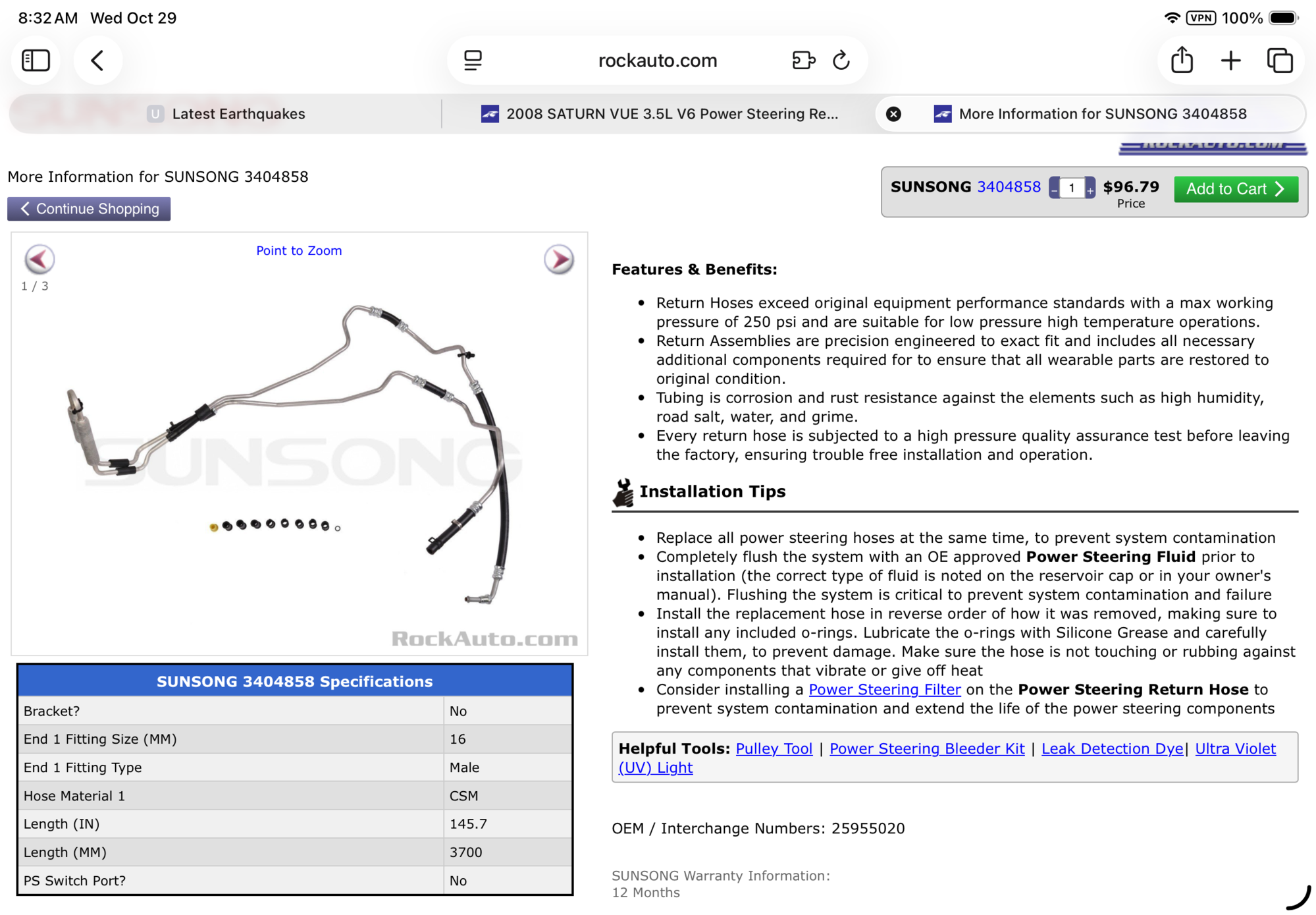

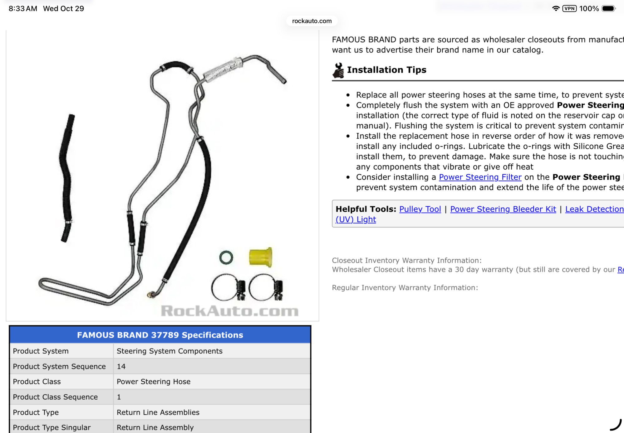

I don’t see which engine but here are a couple. One is for the 3.5 and the other is for the 3.6. Clamps will not hold without a bulb or barb. Even with low return pressure.

I think he has the top one in my post. It has a crimp end that covers the rib shown in his picture.
