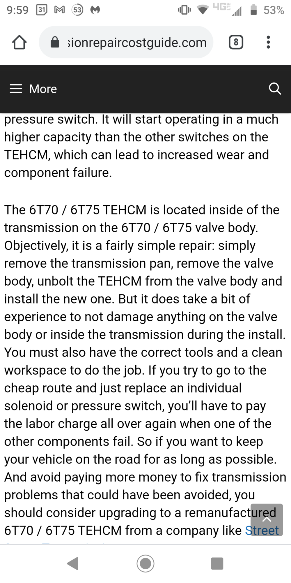

As for the location of the transmission control module, these people are full of crap. Please see the attached screenshot which clearly indicates, as for many other vehicles, the TCM is located inside the transmission. The newer technology can be difficult to troubleshoot to the individual component level but it can be done. However it is much more financially lucrative to replace the entire module, which in this case is incorporated into what is called the valve body which controls transmission fluid pressures and shifting. So I'd sooner charge you $900 for a module I can pull out, swap in a new one, and program it to work in your vehicle. Profit on parts, profit on labor.. you cannot swap in a used TCM due to the way these electronics are built today. Apparently you can only program a blank TCM which has either been refurbished and wiped clean or use a brand new one. I'm sure it is physically possible but the dealer is the only person who has the ability to do it and they will not as it takes money out of their own pocket.
6T70 description.
So if they did replace it then it is covered.

I am still confused as to why the mechanic would lie to you about where the TCM is located on the information is freely available on the internet unless there is some kickback between the used car place and the mechanic for discouraging and preventing legitimate warranty claims.
The website that I took the screenshot from is
https://www.transmissionrepaircostgu...he%20new%20one.
It is highly informational in most respects but is clearly written by someone who sells the replacement part as they imply that you must replace the entire part instead of just the subpart that is defective.
6T70 description.
