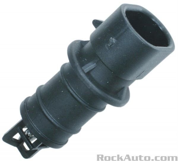

Does it look like this?
Hi, I'm an Air Charge Sensor for a 3.5L Honda V6 engine in the 2007 Vue Redline

Thanks for the replies. I did cross-post this over to Saturnfans as well, I wasn't sure which form was more active. My sensor looks a lot different.
I purchased it from Pepboys. No matter where I looked I always came up with the same part, Standard Motor Products AX160.
