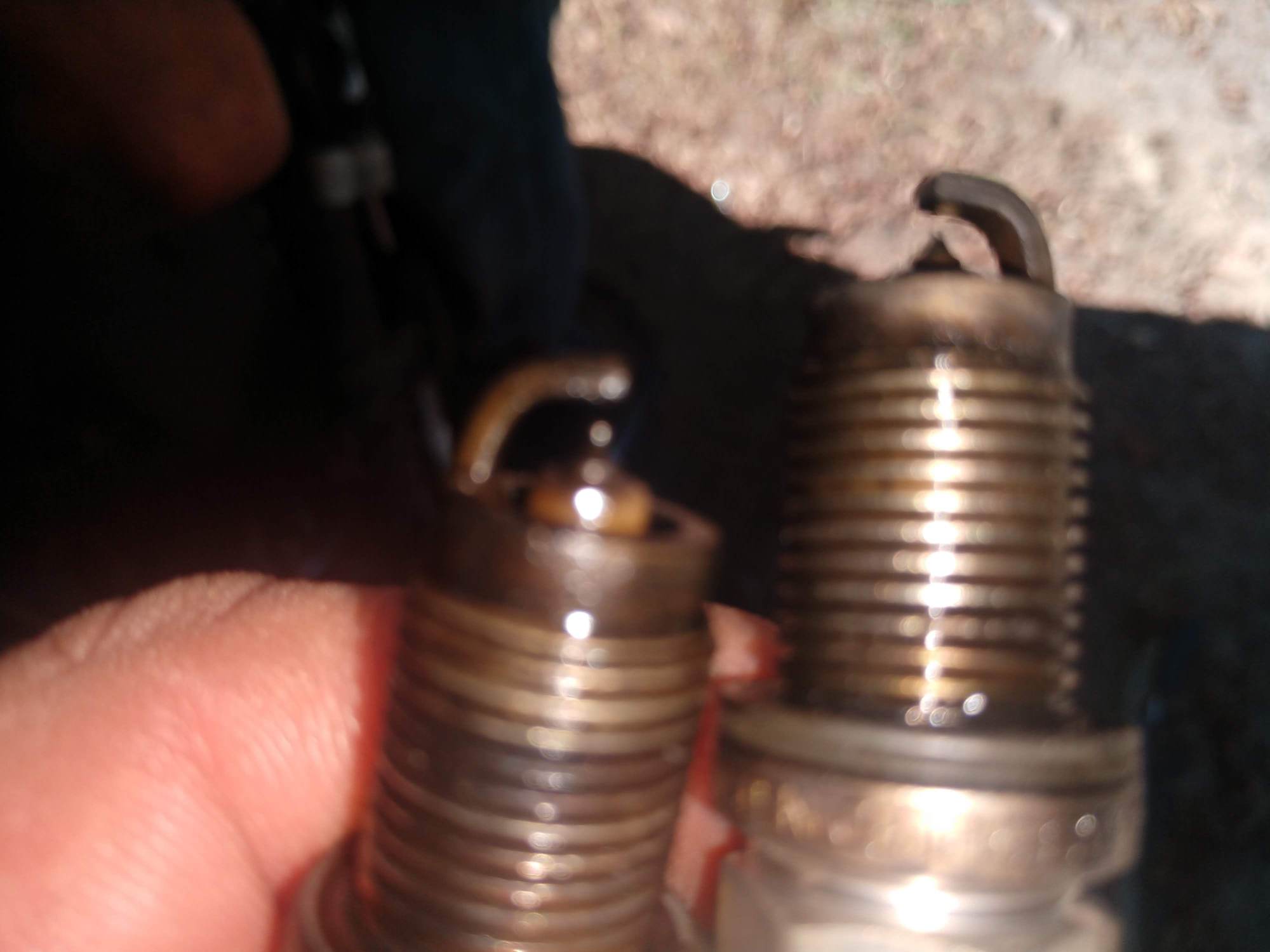

I have verified that there is fire and fuel. I removed the front three plugs and they appear severely worn but obviously the car was running prior to the accident so I am doubtful the plugs could be the issue. I have not been able to find any sensors that are compromised or grounded.
Old Oct 15, 2019 | 07:44 AM
Those plugs look wet to me, but that may just be my eyesight. They look gas fouled. I'm thinking you have a timing issue.You need 4 things to start one. Spark, fuel, air and compression. The key is all 4 components have to be there at the right time. That's where the timing comes into play.
