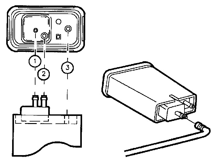

Canister is back at the tank.
Click in the breadcrumbs just below to find entire manual.
Home >> Saturn >> 2000 >> SL L4-1.9L SOHC VIN 8 >> Repair and Diagnosis >> Powertrain Management >> Emission Control Systems >> Evaporative Emissions System >> Evaporative Emission Control Canister >> Service and Repair
Evaporative Emission Control Canister: Service and Repair
TOOLS REQUIRED
^ SA9805E Canister Purge Line Disconnect Tool
^ 7000081-SAT3 ScanTool
Removal
The [1][2]EVAP emissions canister is located in a molded cavity on the top of the vehicle fuel tank.
1. Remove fuel filler pipe and fuel tank from vehicle.
2. Disconnect the 5/8" 90° fuel tank vapor inlet hose fitting from the canister.
3. Remove the EVAP canister retainer clip at the upper end of the canister.
4. Disconnect the 5/16" 90° fuel vapor/canister purge fitting from the canister (use tool SA9805E).
5. Remove the canister from the fuel tank.
Installation
1. Place the [1][2]EVAP emissions canister in the pocket on the top fuel tank. Make sure that the canister vent hose is positioned towards the middle of the fuel tank.
NOTE: If a replacement canister is being installed, make sure that the vent hose is installed on the canister prior to installation on the fuel tank. Orient the molded vent hose on the canister so that when it is installed on the fuel tank the "S" bend will be pointing down.
2. Install the canister retainer clip to the fuel tank, assuring that the clip is over the lower flange of the canister before "snapping" the clip into the locked position.
NOTE: Install the retainer for the purge fitting quick connect into the female portion of the connector. Care must be taken to assure that the locking tab is centered in the window of the female connector.
(1) Canister Purge (2) Vapor (3) Vent
3. Install the 90° 5/16" purge line fitting to the purge port on the canister.
4. Install the 90° 5/8" vapor line fitting to the tank port on the canister.
5. Install fuel tank and fuel filler pipe.
6. Perform the "Service Bay Diagnostic Test" for the evaporative emission system using the Scan tool. This test will verify the integrity of the vapor handling areas of the fuel system.
