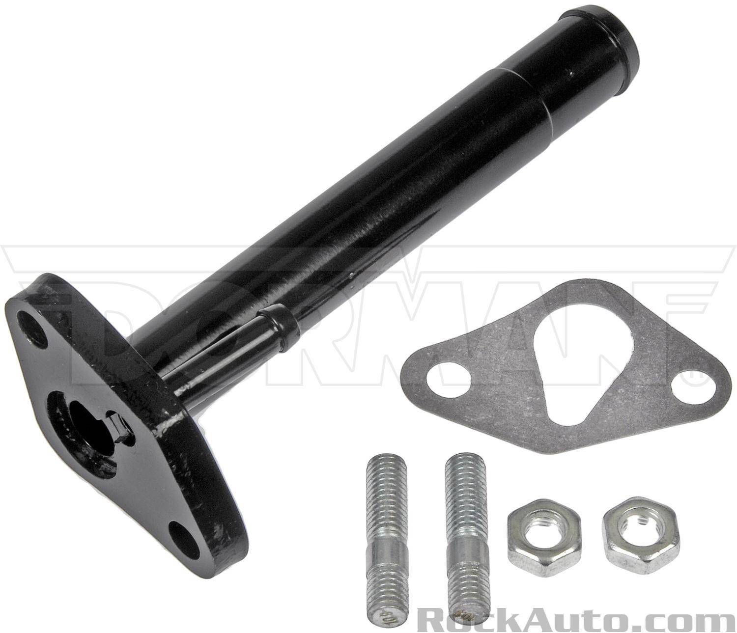

Is this what you are looking for?

I am not sure but I believe not.
