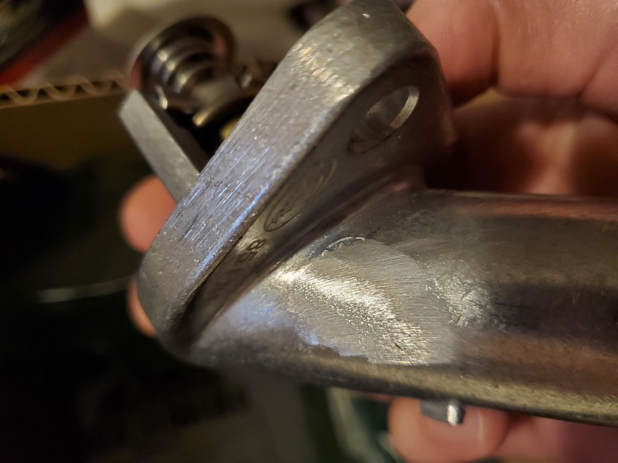

Going to install it hopefully this weekend. Btw it came with rubber ring to go on , do I need to apply any material to this ?
I ended up buying a "gates" brand from rock-auto. About to test it in water. Something very curious is I appears like the side has been grinded, and I swear they grinded away a brand.... there appears to be a "ring" imprinted that didn't get grinded. Anyone ever see this before!?

Posts: 12,410
The dorman one on RockAuto has a made in China raised lettering section right around there. Someone is switching brands / substituting. One of the possible explanations lies in the fact that RockAuto drop ships the vast majority of their parts. They rely on people that warehouse these parts, whether it be aftermarket or OEM, to fulfill their orders. It is therefore possible that this kind of nonsense can occur if somewhere along the line the parts are messed with. Can't even necessarily blame the person who has it now and ships it to you, because they may be the third or fourth owner of the part, having bought it from a clean out of somebody else's inventory, and no one checks every box for correct contents. As far as I can tell the picture of the dorman doesn't even have a dorman logo on it anywhere. I'm beginning to think that these are all made by one manufacturer and then sold under different brand names. I can't tell you which is which cuz I simply don't know. Motor rad I believe labels them up the side with the full name so it doesn't look like it's for a motorad setup which likely means the thermostat that came with it is not a motorad. Maybe. I would just go with what you have. Don't touch any of the surfaces with your fingers. I've been told oil from your hands can affect the operation of the thermostat. I would take a picture of that and contact RockAuto service customer service and ask them what the f is going on with the parts they sell? Clearly it has been handled and modified to disguise its true identity. Just play dumb about how they actually get you the part. That's just unacceptable in my book. I don't care if it's the same exact part I get by ordering a different brand. Somebody undoubtedly swapped something so that they could sell a less expensive part for more.
Like I said just go with it and see if what you have functions properly because at the end of the day that's what matters.
