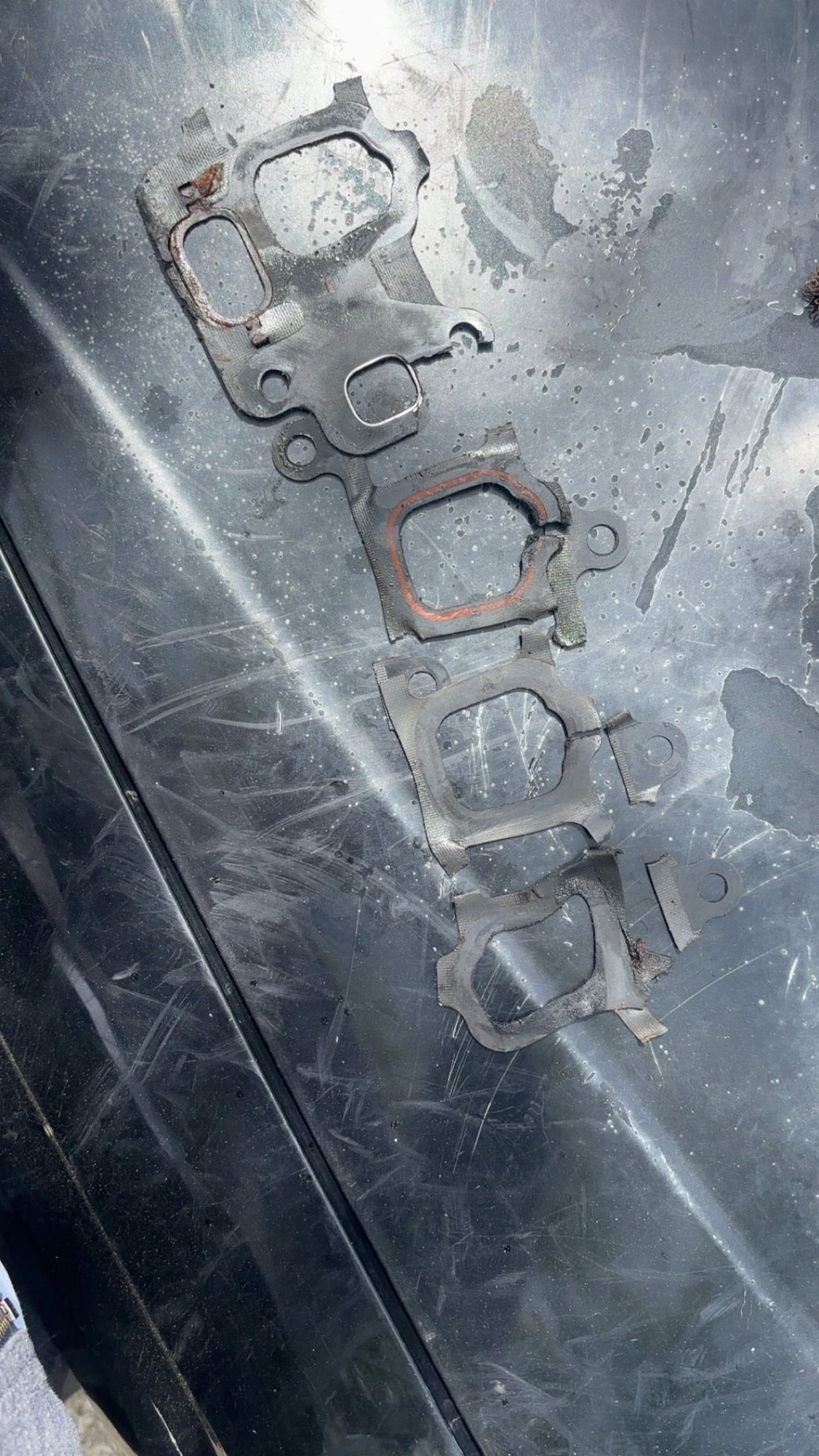

The job is finished! Found the last nut after moving the car and it fell out, got the 9th bolt off after taking off the serpentine belt and power steering pump. Those nuts were a b**** but it’s done. The car idles 800-1000, better than ever before. The old intake gasket was mangled, especially around cylinder one.
My OG intake manifold gasket
