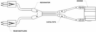

In the case of this pictorial example the crossover, the place where the two separate exhaust pipes are physically connected together is labeled resonator.
