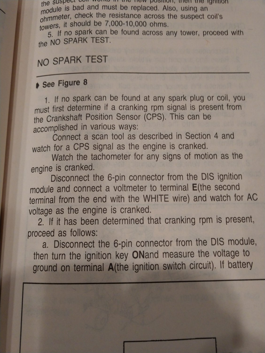

Well here is something I was referring to in that older post. It has to do with the ignition control module ICM and associated wiring to the PCM. Unfortunately, this diagram is from first generation s cars. I know it has changed because you cannot use a first generation ignition module on a second or third gym Saturn S Series car. That being said, here is some troubleshooting info. If this person is a professional mechanic they should have access to the actual factory service manual or all data equivalent as to how to troubleshoot the ICM. They are probably about 200 bucks so they are not a throw money at it part. The issue can also be the wiring interconnecting it to the PCM. Well here you go and apologies for the mega delay.
Not too many reported cases of these ICM modules going bad. Emphasis on the reported cases part. I would search and see if you could find the model correct version of the picture I included above of the ICM schematic kiwi come here oops that was my cat she has now recorded forever on the forum.
So you would want an ICM diagram for a second generation S car.
Hope this helps you or whoever is receiving the vehicle. 99% of the time it is the crank position sensor or associated wiring.
