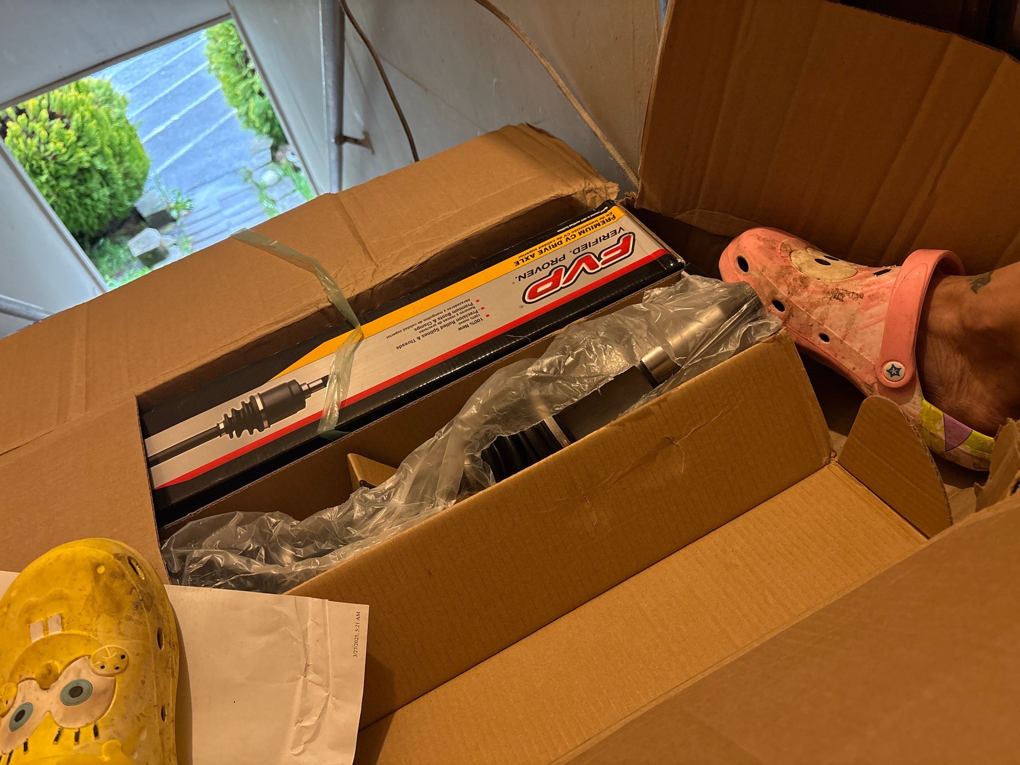

‘95 sl base model, sohc, standard drivetrain, etc etc.

Basic replacement, i will address whatever issues come with it as the parts get replaced.
right now though, people locally are used douche bags.
so ive decided to take matters into my own hands, to avoid any fu*ckery, and shenanigans. Ill go for an alignment at “less schwag” (grammatical play intended) after.
i need to know of any important info that would be necessary for a cv acle replacement. There is a tiny vague photo “STOP! Read this first” pamphlet. (2”x2” square)

Says something about removing an old clip and replacing it at the same time. From appearance of the mechanism to be replaced, doesnt seem too bad, unless there is underlying issues with my little trusty.
