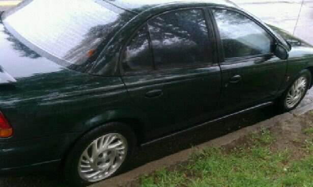

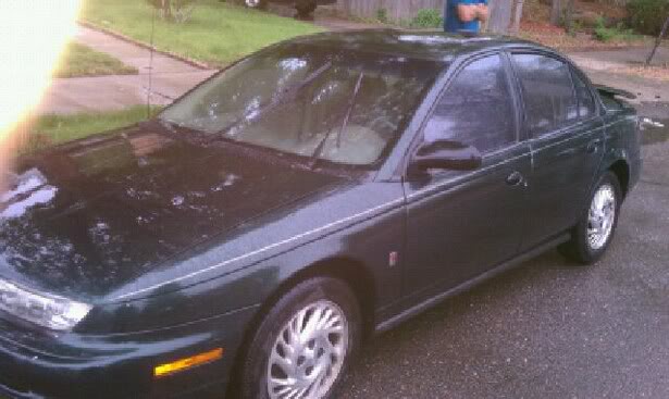

1998 Saturn SL2. 122K miles 4 door. Nice leather interior, minor hail damage to the roof, new tires, oil change, tranny fluid and filter changed, air filter, spark plugs, stereo system. A/C blows cold, but only one window currently works. The guy that sold it to me told me that there's a plastic clip that needs to be replaced in the windows for them to work. However, there's no sound when using the driver window, so I suspect it's actually the motor. Paid $1800.
Now, one thing that I noticed that I didn't at first is that the "Service Engine Soon" light is on when the car is in axillary mode, but it isn't on when the car is started. Is this actually something to be worried about? I never noticed it before because I haven't had it in aux mode except to check if the ABS light came on and that's when I noticed it. So is the check engine light actually on? If it's not, I can be at peace of mind. I feel I got a pretty good deal.
Lengthy post, time for pics!
